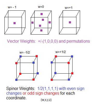

An easy way to visualize this is to consider SU(n+1) ~ An instead. Then the Dynkin diagram is a line which has an obvious reflection symmtry. This outer automorphism simply acts by mapping any representation into its complex conjugate. That's all to it!
Probably you are familiar with SU(3). Then you know how the triplet and anti-triplet representations look in weight space. And then you also see what kind of rotation of weight space maps both into each other.
Yes, looking at the transformations of the weights is a great way to understand the triality automorphism of so(8), and the corresponding isomorphisms between positive and negative chiral spinors and vectors.
If you want to play with this automorphism explicitly on the Lie algebra level, as a map between generators, there isn't much literature on that. You mostly have to figure it out on your own. (I worked this out recently, for so(8) and so(4,4), and will include it in a future paper if all goes well.)

Talking a little bit more about so(8).
I read that the simple roots of so(8) can be written as
a_1 = (1,-1, 0, 0)
a_2 = (0, 1,-1, 0)
a_3 = (0, 0, 1,-1)
a_4 = (0, 0, 1, 1)
whereas the fundamental weights can be written as
b_1 = (1, 0, 0, 0)
b_2 = (1, 1, 0, 0)
b_3 = 1/2(1, 1, 1,-1)
b_4 = 1/2(1, 1, 1, 1)
Also, the Cartan matrix of so(8) is
A_ij = (2 -1 0 0; -1 2 -1 -1; 0, -1, 0, 0; 0, -1, 0, 2)
But then I also read that a_i nand b_j are related by the Cartan matrix simply via a_i = A_ij b_j. Unfortunately, that does not work for my given a_i and b_j.
What is wrong?

Lapidus said:
Since suprised said in an earlier post that an easy way to see the outer automorphism of the three representations of so(8) is to look at the weight diagrams, I would now like to dothat. But again I need a little help...
Since I got for so(8) the fundamental weights
b_1 = (1, 0, 0, 0)
b_2 = (1, 1, 0, 0)
how to get the weight diagrams? Any book to recommend that explains well what do to?
Or can I just look it up somewhere?
thanks
The fundamental weight b_1 corresponds to the vector representation. All the other weights will be permutations of the 4 coordinates and their negatives.
[itex](\pm 1,0,0,0);\, (0,\pm 1,0,0); \, (0,0,\pm 1,0);\, (0,0,0,\pm 1)[/itex]
The fundamental weights b_3 and b_4 correspond to the spinor representations and the other weights are obtained by changing signs in pairs of the coordinates.
[itex](\frac{1}{2},\frac{1}{2},\frac{1}{2},\frac{1}{2});\,(-\frac{1}{2},-\frac{1}{2},\frac{1}{2},\frac{1}{2});\,(-\frac{1}{2},\frac{1}{2},-\frac{1}{2},\frac{1}{2});\,(-\frac{1}{2},\frac{1}{2},\frac{1}{2},-\frac{1}{2});\,(\frac{1}{2},-\frac{1}{2},-\frac{1}{2},\frac{1}{2});\,(\frac{1}{2},-\frac{1}{2},\frac{1}{2},-\frac{1}{2});\,(\frac{1}{2},\frac{1}{2},-\frac{1}{2},-\frac{1}{2});\,(-\frac{1}{2},-\frac{1}{2},-\frac{1}{2},-\frac{1}{2})[/itex]
and
[itex](-\frac{1}{2},\frac{1}{2},\frac{1}{2},\frac{1}{2});\,(\frac{1}{2},-\frac{1}{2},\frac{1}{2},\frac{1}{2});\,(\frac{1}{2},\frac{1}{2},-\frac{1}{2},\frac{1}{2});\,(\frac{1}{2},\frac{1}{2},\frac{1}{2},-\frac{1}{2});\,(\frac{1}{2},-\frac{1}{2},-\frac{1}{2},-\frac{1}{2});\,(-\frac{1}{2},\frac{1}{2},-\frac{1}{2},-\frac{1}{2});\,(-\frac{1}{2},-\frac{1}{2},\frac{1}{2},-\frac{1}{2});\,(-\frac{1}{2},-\frac{1}{2},-\frac{1}{2},\frac{1}{2})[/itex]
Here is a rough picture, in w,x,y,z coordinates.
Note that the adjoint representation (b_2) will correspond to the bi-vectors are all the sums of distinct vector weights. (8 choose 2 = 28). These will occur on the edges of the middle cube (w=0) and faces of the left and right cubes (w=+/-1) in the upper row, (plus the 4 zero weights occurring at the center of the middle cube w=0)

This is explained in most textbooks on group theory, there are zillions of them. My favorite
is "Group theory in physics" by Cornwell. Earlier editions had 3 volumes but it seems that there are now newer, abridged editions.
As for your question, the basic point is that the weights of the vector and spinor reps of SO(8) have the same length, so they are related by a simple rotation in weight space. In other words, in order to find the triality outer automorphism, you need to find the rotation matrix that maps the fundamental weights into each other. It is as simple as that!
(It is not an inner automorphism, or Weyl tranformation, because that maps between the weights of the same representation. Outer automorphisms map between weights of different reps).
