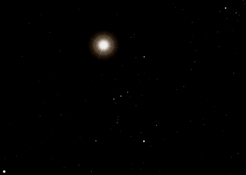

wikipedia estimates about -12 magnitude. For reference, also from wikipedia, the apparent magnitude of the full moon is -12.74... so yes, it will be quite magnificent. And since wikipedia also says it should remain at about -12 magnitude for a few months, it would be very cool to see it alongside the full moon.
Star field simulation with one very bright, glowing white star with a faint halo in the upper left, surrounded by smaller scattered stars on a black background.

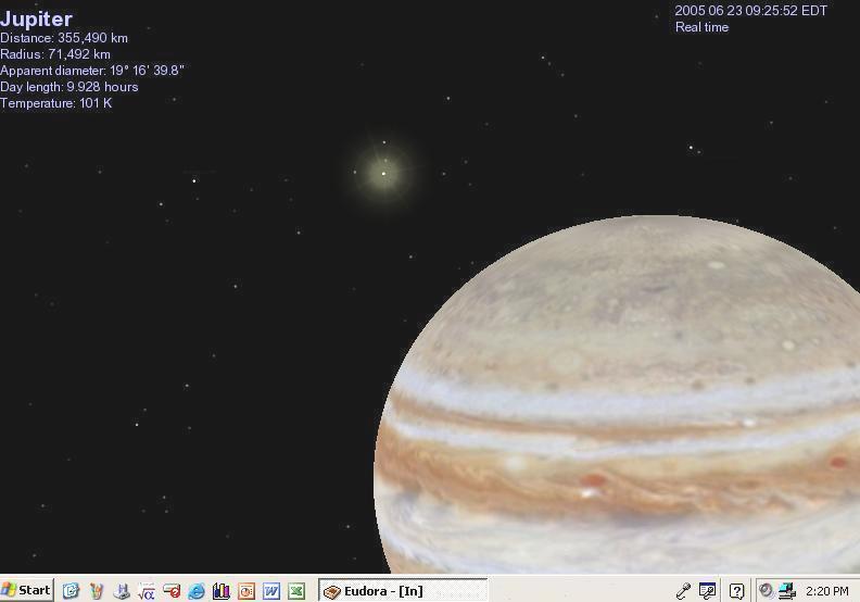

from wikipedia, this is an image it says is taken from Celestia and shows Betelgeuse as it might appear from Earth if it goes supernova and someone looks at it. Although it doesn't show much of what sort of lighting it would provide on Earth... it sure does look bright, reminds me of the following picture that apparently shows the sun from Jupiter's distance, and in fact looks a bit brighter.
Celestia screenshot showing Jupiter large in the lower right against a dark sky, with a bright glowing star-like point upper left; label reads Jupiter, distance 355,490 km, radius 71,492 km, temperature 101 K.

Guys what i have noticed that pic by shisikabob is highlighted rigel insted of betalgeus
No, it correctly shows Betelgeuse. Rigel is at the bottom right of the constellation and makes up one of the legs/feet.
Ya, i was misguided i thought it was inverted and i was asuming that its legs were upward but now its clear
