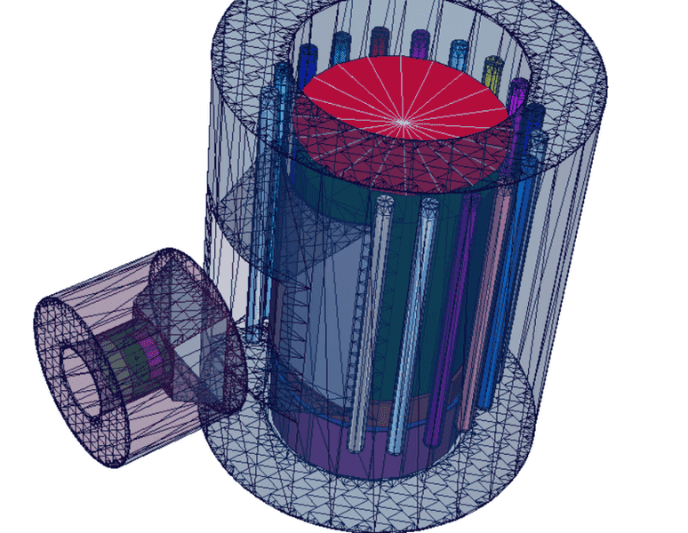

Hi, i am looking for some help on MCNP, more precisely mcnpx 2.7 for neutron simulation.
I created a model of semi opened detector with a various number of 1 inch He3 (here 16)
and i only obtain 6-7% efficiency.
the fact is, I've others technicals notes about same "types" of detector, for example 12 He3 1" disposed in square (wich is not the best positionning) where it's mentionned 11% of efficiency for approximatively the same sort of matrix.
In my case the matrix is composed of Pu240, below you will find my physicals parameters for the simulation.
Do you have some feedback about that ? can someone tell me if i am wrong somewhere to obtain an so low efficiency ?
I am in the blur...
Thx by advance

F4:N (340 341 342 343 344 345 346 347 348 349 350 351 352 353 354 355)
c
FM4   -1 4 103          $   -1 X 103  /// x= numéro mat hélium
SD4 1                   $ calcul volume tubes
c
ctme 5              $ TALLY Neutron
PRINT
