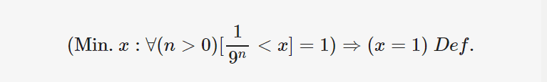

The ##\LaTeX## expression in my post got mis-rendered, and trying to edit it caused it to not be rendered, so here it is as an image:
The "Def." in the expression denotes that it's a definition. I think that I don't need to show a complete definition for all decimal expansions to write a definition by which 0.999... is equal to 1. I think that the definition I provided suffices for the purpose.
I see that definition as claiming that 1 is the smallest real number that is greater than every member of the set {1/9, 1/81, 1/273, ...}. I can come up with a counter-example. What about 0.5?
Presumably you actually wanted to define 0.999... as the least upper bound of the set {0.9, 0.99, 0.999, ...)
Possible definition: The value of a decimal string that extends indefinitely to the right of the decimal point is the least upper bound of the set of values obtained by truncating that string at some finite point.
Now if you want a proof, you need to use the definition in the proof.
Thanks, @jbriggs444, I wrote it incorrectly ##-## I'll fix it later.
Here's the incorrectly written version: $$(\text{Min.}~ x:\forall(n>0)[\frac 1 {9^n}<x]=1)⇒(x=1)~ Def.$$
##-## and here's the corrected version: $$(\text{Min.}~ x:\forall(n>0)[0.(9)_n<x]=1)⇒(x=1)~ \text{Def.}$$
