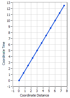

Now here is a diagram showing the same clock in a frame moving at -0.6c with respect to the first frame:
Line graph of coordinate time against coordinate distance, showing a straight blue line with dots at equal steps rising from the origin, with time increasing faster per unit distance than in the frame it is compared against.
Gamma at 0.6c is 1.25. Notice how the dots are spaced at coordinate intervals of 1.25. This is easily seen by looking at the fourth dot up which coincides with the coordinate time of 5 (since 4*1.25=5).
Remember, there's only one clock involved.

  • Line graph of coordinate time against coordinate distance, showing a straight blue line with dots through the origin rising to about 12.5 at distance 7.5, with evenly spaced markers along it.
