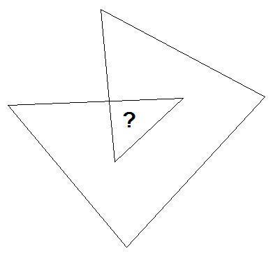

That does not even cover cases like the attached figure. And there are much more problematic objects.
If you did not get a proper definition of "area" in class, you have to do some hand-waving, as there is simply no definition you could refer to. As an example, you can start with the formula for the area of a triangle, and show that this scales in the right way - and then try to find some way to express your "shapes" as a set of triangles.
