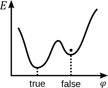

I always thought of it as analogous to false vacuum decay (but inverted).

Luckily, doens't apply to this one or we'd all cease to exist!
