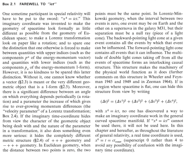

This is what MTW said about the imaginary time in Gravitation:

Algr said:
Wouldn't imaginary time be a fifth dimension?
No. It's just multiplying time by ##i## to make the Minkowski interval look like the Euclidean distance in a 4D space. It's a mathematical trick which, as the MTW quote @Hill gave shows, is only workable in flat spacetime and is of limited value even then.
