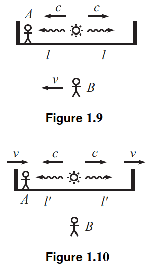

Time is relative. Maybe you can better understand the related scenario of Morin.
A light flash happens in the middle of a train.
  • In the train-frame (##A##, figure 1.9), the light hits both ends of the train simultaneously.
  • In the embankment-frame (##B##, figure 1.10), the light hits first the rear end of the train and then the front end of the train.
Source:
https://scholar.harvard.edu/files/david-morin/files/relativity_chap_1.pdf
via:
https://scholar.harvard.edu/david-morin/special-relativity
