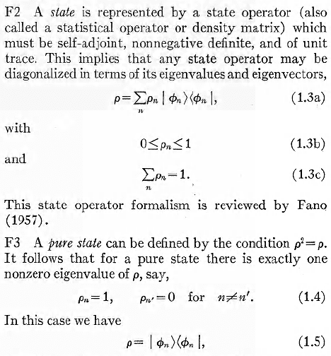

It seems that Ballentine says the same thing in a different way :
From "The Statistical Interpretation of Quantum Mechanics"
244860
/Patrick

I still don't understand what you mean by that. Of course, what you quoted from Ballentines paper is correct. For any statistical operator ##\hat{\rho}##, which is a self-adjoint operator there's an eigenbasis,
$$\hat{\rho}=\sum_{n} \rho_n |\phi_n \rangle \langle \phi_n|.$$
Since ##\hat{\rho}## is positive semidefinite and of trace 1 you have ##0 \leq \rho_n \leq 1## and ##\sum_n \rho_n=1##.
##\hat{\rho}## thus represents a pure state if and only if for one ##n=j## you have ##\rho_j=1## and ##\rho_n=0## for all ##n \neq j##. Then and only then it's a projection operator as it must be for a pure state.
Now take a q-bit. What do you mean by "the q-bit is well defined against some basis"? Do you mean that then there's a spin component in some direction which has a determined value? But that can be only the case if ##\hat{\rho}## represents a pure state. For a q-bit this can be seen elegantly as follows.
Here the Hilbert space is two-dimensional and in an arbitrary basis (usually chosen such that it's the eigenbasis of ##\hat{s}_3=\hat{\sigma}_3/2##) you can write it in terms of hermitean ##2 \times 2## matrices, of which a basis is ##\hat{1}##, ##\hat{\sigma}_j## with ##j \in \{1,2,3 \}##, where ##\hat{\sigma}_j## are the three Pauli matrices. Then any statistical operator can be written in the form
$$\hat{\rho}=\frac{1}{2} (\hat{1} + c_j \hat{\sigma}_j)$$
with real ##c_j##'s.
Now by a unitary transformation, representing a rotation ##\hat{D}_{1/2}(\vec{n} \varphi)##, you can diagonalize the statistical operator. Redefining our spatial directions accordingly then the matrix of the statistical operator in this basis gets
$$\hat{\rho}'=\frac{1}{2} (\hat{1} + r \hat{\sigma}_3)=\frac{1}{2} \mathrm{diag}(1+r,1-r).$$
We have ##|r|=\sqrt{c_1^2+c_2^2+c_3^2}## and the properties of the statistical operator implies that ##r \in [-1,1]##.
This implies that ##\hat{\rho}## represents a pure state with a determined value ##r/2## for the spin-component in 3'-direction iff ##\rho \in \{1,-1 \}##. This means that one spin component for a statistical operator ##\hat{\rho}## takes a determined value if and only if ##\sum_j c_j^2=1## and thus ##\hat{\rho}## represents the corresponding pure state, and the direction of the then determined spin component is given by ##(c_1,c_2,c_3)##.
In an arbitrary basis thus all (pure as well as mixed) states of the q-bit can be represented by three real values ##(c_j)## or, written as a vector ##\vec{c} \in \mathbb{R}^3##, with ##|\vec{c}| \leq 1##. That's known as the Bloch sphere. Any pure state is represented by the surface of this Bloch sphere, i.e., by a unit vector ##\vec{c}##. All other states with a ##\vec{c}## with ##|\vec{c}|=r<1## are mixed.
Likes weirdoguy
