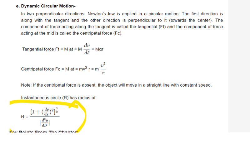

I am trying to understand circular motion from IIT JEE curriculum.
Below.
Can someone show that the instantaneous circle is indeed given by when the centripetal force is removed?
This can be found at https://www.vedantu.com/iit-jee/circular-motion
That page seems quite confused. In general, dynamic circular motion requires an object to be constrained to move in a circle of given radius.
The orbit of a satellite in general is an ellipse. If a satellite is in a circular orbit and you give it a tangential boost, it will transition to an elliptical orbit, not to a smaller circular orbit.
Also, the formula you circled relates the decomposition of forces for an arbitrary (not necessarily circular) trajectory into instantaneous tangential and normal (centripetal components).
View attachment 320998This can be found at https://www.vedantu.com/iit-jee/circular-motion
First let's correct this, which is obviously wrong:
Fc = M at = mv2 r = ##m \frac{v^2}r##
Presumably they meant ##F_c = M at = m\omega^2 r = m \frac{v^2}r##.
I interpret your question as "show that the instantaneous circle is indeed given by the formula circled when there is no centripetal force".
Easy. If there is no force normal to the velocity then the motion is a straight line. ##\frac{d^2y}{dx^2}=0##, so R is infinite.
We must be looking at different circled formulae.
haruspex said:
Sure, but how does it relate to decomposition of forces?
The issue is that page is no longer talking about circular motion but about general motion with tangential and centripetal components.
The material is explicitly under the heading "dynamic circular motion", which is wrong, IMO.
Yes, it's a mess.
