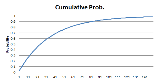

For the double 6 question, If you are given the choice of '5 or less' or 'more than 5', given that the odds of a success on any given roll is 1/36, you want to consider the odds that your first double 6 shows up on the nth roll.
## p(1) = 1/36##
for n >1,
##p(n) = 1/36\left( 1- \sum_{k = 1}^{n-1} p(k)\right)##
And your cumulative odds would be:
##p(n \leq N) = \sum_{k = 1}^{N} p(k)##
This is independent of when the last double 6 showed up. If your cumulative odds of seeing the first double 6 were at least 1/2 before the 5th roll, you should take the bet, since you said "even odds".
Below is a graph of probability that the first double six will occur on the nth roll. You can see that the plot crosses the .5 mark at around 25. So I would take the even odds on 25 or less, but anything less than 25 rolls, I would choose the alternative "more than" option.
Line graph titled Cumulative Prob., with probability from 0 to 1 on the vertical axis and values 1 to about 150 on the horizontal axis, showing a rising curve that crosses 0.5 near 25.
This does not contradict the fact that the expected number of rolls will be 36, since the expected value is defined as:
##E(n) = \lim_{N\to \infty}\sum_{k = 1}^{N} k*p(k)##
which calculates out to 36 in this case.
