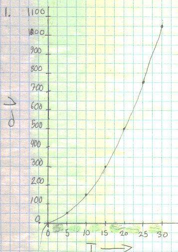

1. Plot the following motion of an object on a d-t graph.
Position (m north of the CN tower) Time (s)
0 0
50 5
150 10
300 15
500 20
750 25
1050 30
1. Describe the motion of the object.

The problem is, the area under the velocity-time graph is supposed to give the displacement. I know the displacement is 1050m, but the area of my velocity-time graph yields only 900. What gives?

well, your problem was that you had a position vs. time graph, not a velocity vs. time graph.your position vs. time graph was quadratic; therefor, your velocity vs. time graph will be linear IE the triangle.
well, the function for position is x(t)=1/2at^2 + v0t + x0
so, that measn that the time differential for the position function is the velocity function. v(t)=at+v0

Here's the Velocity-Time graph with the area under the curve measured.
http://img242.imageshack.us/my.php?image=graph3qs5.jpg
And here's the Distance-Time graph from Question 1

Don't worry, you've not done anything wrong. The fact that the question says
5. Calculate the area under the velocity-time graph. Compare your answer to the value you expected to obtain. Explain your comparison.
hints at the fact that you will get an answer different to what is expected.
Since you are only given the information about the displacement and time from which to calculate the average velocity, you had to make one assumption about the intial velocity when the object was at position x=0, namely that the velocity at t=0 is zero. However, suppose the intial velocity was not zero. How would this affect the question?
Can you find the initial velocity such that the distance is what you expected? [hint: s=ut+(at^2)/2]

Not quite: Using the equation: s=ut+(at^2)/2. We require s=1050, t=30, a=2 and we want to find u.
Putting the numbers in, we obtain, u=5m/s
If you plot this graph, you will obtain a velocity of 65m/s at t=30. This is due to the fact that the graph has an intercept, so the area under is not a triangle (it's a triangle on top of a rectangle). Your logical argument misses this point, as on calculating the area, we would then have the 900m from the triangle (the same as in your graph, but shifted up) and the resulting 150m will come from a rectangle of height 5m/s and length 30s. (Try it for yourself: plot a v-t graph like before, but increase each value of v by 5m/s. Then calculate the area under the graph).
