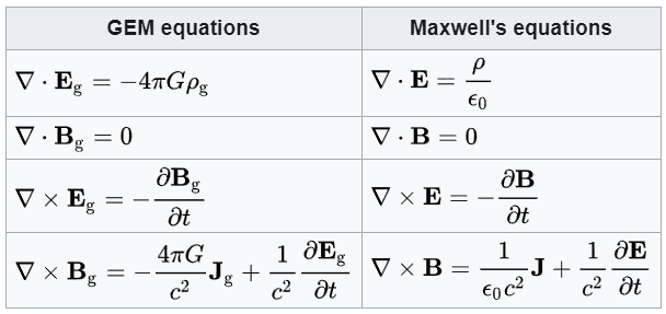

The definition says Gravitoelectromagnetism (GEM), refers to a set of formal analogies between the equations for electromagnetism and relativistic gravitation; specifically: between Maxwell's field equations and an approximation, valid under certain conditions, to the Einstein field equations for general relativity.
But I don't find an useful real example.

Under certain simplifications the Einstein field equations simplify to the same form as Maxwell's equations. When you do the simplification mass density and mass density flow occupy the same place in the maths as charge density and current density in Maxwell's equations, the Newtonian gravitational field acts like the electrostatic field, and a "gravitomagnetic field" acts like the magnetic field.
The correspondence is not precise because you can only have positive mass density where you can have positive or negative charge density. And the equations are only approximations to the full form of the Einstein field equations.
Does that help?
What @Ibix describes is "gravitomagnetism", which is fairly useless. In some situations it is a good approximation, but this doesn't spare you from the full GR, because you need to know if you are in a situation where this approximation works or does not.

They're the same thing. What @Ibix posted pretty much matches the description given on the Wikipedia page for "gravitoelectromagnetism". "Gravitomagnetism" is just focusing on the "magnetic" part of "gravitoelectromagnetism" (the "electric" part is just ordinary Newtonian gravity).
