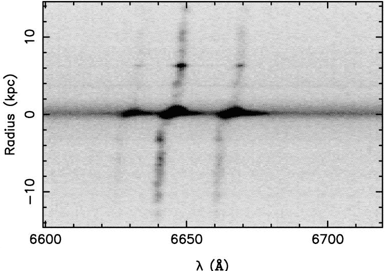

Do you happen to know whether the spectrometers measuring such rotational shifts have the resolution to isolate the two sides of galaxies that happen to be edge on with respect to us? In other words, can we actually identify one half as redshifted and the other as blueshifted, or does the spectrometer take in a smear of light from the whole galaxy, and we calculate the rotation rate based on the spread of the wavelengths (and simply assuming the redshifted portion is receding, etc.)? Perhaps they do both, depending upon the galaxy's "visual size" (subtended angle).
If the galaxy is near enough, and hence large enough in angular size, the spectrograph can definitely resolve the varying redshift across the galaxy. Here's an example from the Hubble STIS.
Here's another example (UGC 2936):
As a rule of thumb, if a galaxy is resolvable as a line , you can place a spectrograph across the image.
Anyone have any idea what accounts for the breadth of the spectral lines at the galaxy center? Is it just a smear due to over-exposure, or simply to the finite size of the slit used to filter the light, along with the smear of tangential velocities that passed through the slit filter?
Radial velocities increase near the central black hole and all these stars might be too close to resolve that region.
