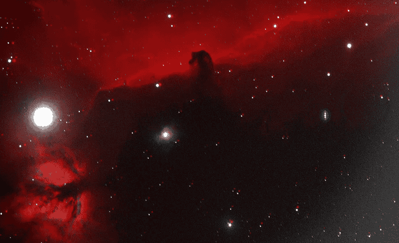

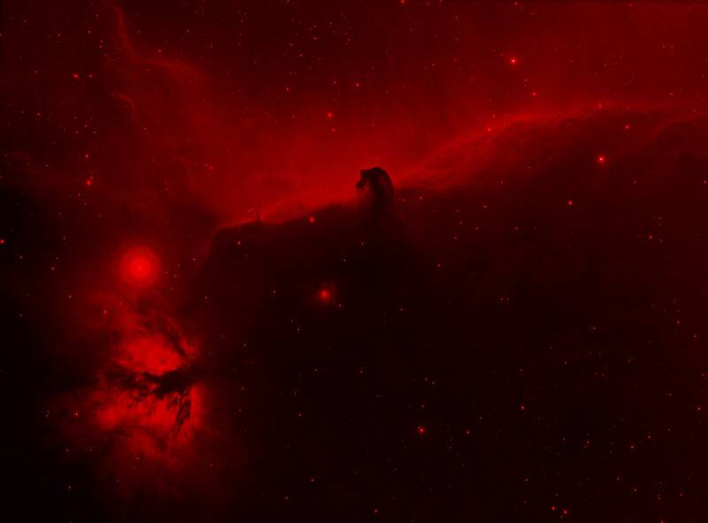

As I mentioned in another thread, I'm imaging the Horsehead Nebula right now. On the evenings of 2/5 and 2/6 from suburban Philly between 6:30 and 9:00pm I captured an unknown object/phenomena about a half degree below and to the right of the horsehead (when oriented upright). It is 3 lights in a line, and it appears well-defined in green (2min exposures, f/5.25, scale 1.17 arcsec/pixel), barely in blue and not at all in red (Ha, 4min). At first I thought it was a rogue galaxy (they often appear unexpectedly in astrophotos) but then I realized it's moving. Not steadily, but apparently back-and forth. It's noticeable in a scale of a few minutes, but was still in almost the same spot a day later.

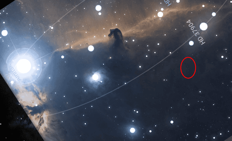

My Starry Night software shows no objects in the area (manmade, comets, asteroids, etc.). My leading theory is a relatively new geosynchronous satellite (body and two solar panels) that has just a bit of north-south drift. Other thoughts:
  • It doesn't seem to be internal since they are point sources of light. That tells me "distant", small objects, not, say, internal reflections.
  • The halo doesn't seem to match the star halos. I'm not sure what that could mean (its own cloud around it?).
  • I haven't done any math on rates, directions or sizes yet.
  • I was hoping other astrophotographers might take a look.
  • I'm headed on vaca so I won't be able to analyze my photos more before next week.
Below are a downsampled photo of the scene (10 frames/20min, aligned and stacked on the "object"), a full scale zoom, and an obligatory preview of the overall work; just the red (Ha) data (the nebula is like 99% red anyway).

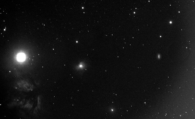

I wasn't sure at first, the relationship between pics 1 (the object) and 3 (the Nebula), since neither is visible in the other. But I see they are of the same area of sky, as is apparent in this superposition:
Nothing appears in Stellarium either:
I'm not sure Heavens Above shows GSO sats, so I'm looking at a list of them in Wiki.

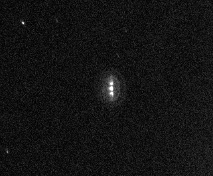

If it was only a single "dot", instead of 3, I might have guessed one of the following. Most of those listed below passed through the area you are looking, in your timeframe, but are a bit closer to the Great Orion Nebula, rather than the Horsehead, except for the two indicated. (Next time, try to narrow down the time a little better.)

But the fact that you're seeing 3 "dots" could be an indication they're a set of new satellites -- as you suspected -- that were launched together in a batch, but haven't yet reached their final orbits yet. If that's the case, then my Stellarium software isn't going to be of much help (either Stellarium isn't showing the new sattelites yet, or if they are shown, they may have stale two-line element [TLE] data due to maneuvers).
Before we conclude it's a set of geosynchronous sattelites (which I'm gussing they probably are), I do have to ask:
Oh, it can't be one object (one body and two attached solar panels).
Three separate geosynchronous satellites relatively close to other, maybe. Some rocket launches include multiple satellites in the payload, so this isn't out of the question, although it is unusual for geosynchronous satellites.
But it can't be just one big satellite that you're observing -- not without it zipping across the sky really quickly because it's in low earth orbit (LEO).
At the distances we're talking here (geosynchronous orbits) we're not going to make out any detail whatsoever with a backyard telescope. Even something as large as the ISS couldn't be much more than a couple of pixels at that distance.

  • The time is what it is: 7-9pm give or take a few min. The object was visible the entire time as far as I can tell remember from a quick flip through the subs.
  • The scope is an Explore Scientific 127mm apo refractor.
  • Geo orbit; right, what I don't know is how much or little oscillation there is for geosynchronous. Miles? Thousands of miles? And is geostationary absolutely perfectly stationary?
  • Regarding the size; good point: geo isn't leo; it's much further away.
  • And yes, discernable motion over a few minutes, not a full period oscillation.

Don't forget, each of the lens elements and filters have anti-reflective (AR) coatings and are strongly wavelength dependent. Some wavelengths might make it through and some may not depending on the nature of the AR coatings, regardless of the thermal nature of the source.
Given the information I have as I write this, my #1 suspect at this point in time is a lens flare caused by Alnitak. Notice in the image that Alnitak is opposite the three dots, assuming the central axis of the optical system is in the center of the image. This is indicative of lens flare reflections.
I'm not 100% certain, but if I was a betting man that's where I would put my money at this point in time. The three dots are reflections of Alnitak off of varius lens elements in the system. Each of the three dots could correspond to a different lens element reflection path.
Lens flares have a typical characteristic that the flare is opposite that of the bright source. If the source is to the upper right, the flare is to the lower left. Change the pointing such that the bright object is at the bottom of the frame, the flare will move to the top of the frame.
This is consistent with Alnitak being on the left of the frame, and the three dots being on the right of the frame.
The Explore Scientific 127 APO is an air spaced doublet, meaning their are two lens elements in the objective. Unless Russ has the Explore Scientific 127 FCD100 version, in which case it is a triplet with 3 lenses in the objective. I'm also assuming that Russ is using either a focal reducer or at least a field flattener, and in either case, that's another few lens elements. The point is that there are many lens elements in Russ's system. There's also a filter which fits in there too somehow. There's a lot of potential for reflections and lens flares.
And look at how bright Alnitak is in the image. It could be because of the stretch, but yeah, Alnitak is the bane of all astrophotographers. It gets everybody in the end because we all love the Horsehead and Flame nebulas.
So could it be another star besides Alnitak (such as Mintaka, Rigel, etc.)? 'Could be. But my money's on Alnitak. It's in exactly the right location to cause a lens flare, if those three dots are in fact caused by reflections.

But was in roughly the same location, more-or-less, relative to the Horsehead nebula, for the duration of 7-9 PM? I mean, was it in the field of view of your Horsehead Nebula image for the whole 2 hours?
Within maybe 10-20 arcsec the entire time. Not moving much.

The fact that it's filter dependent might be a clue. What type of camera and filter holder are you using?
Perhaps, but it doesn't seem quite perpendicular to Alnitak....much less in a line away from it. Camera is a Zwo Asi1600 and their filter wheel.
