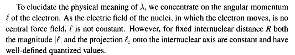

in the book Molecular Physics of Wolfgang Demtroder, he claims for hydrogen ion molecule ##H_2 ^+## the total angular momentum in absolute value is a constant quantum number. I never saw it any other book and I think it's wrong, because there is no reason for it and he doesn't prove it. here is what he says in the book:
what do you think?
This all comes from Noether’s theorem. The nuclear potential in ##H_2^+## is not spherically symmetric, so the total angular momentum is not conserved. However, it is axially symmetric, so quantities associated with the axis of symmetry are conserved.
