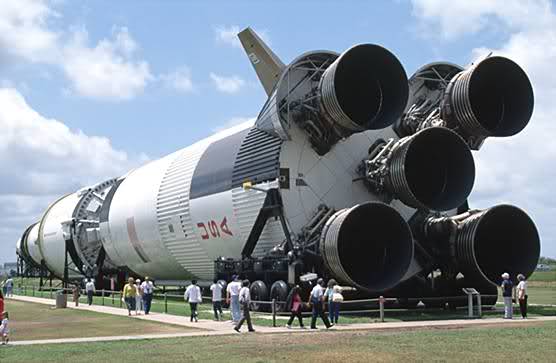

It would definitely be more efficient. Just compare the size of the craft needed to get astronauts to the Moon;

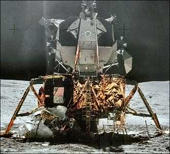

with the crafts that got them back
