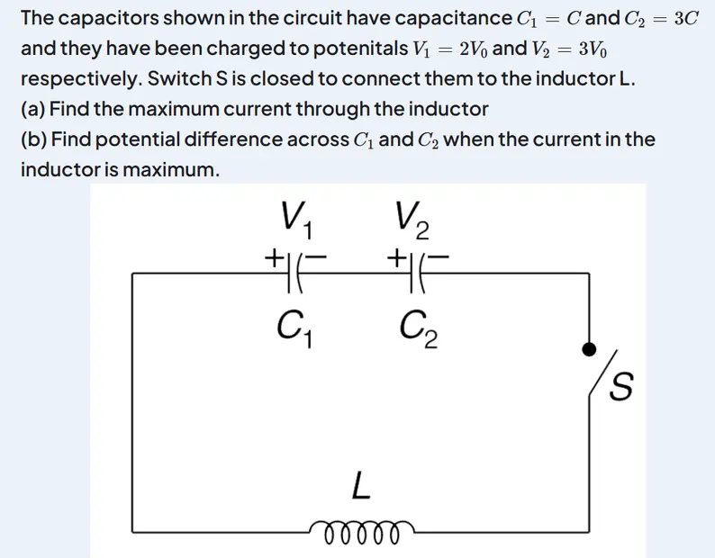

picture below
1/2Li^2, Q=CV
Circuit diagram with capacitor C1 labeled V1 with plus and minus signs, capacitor C2 labeled V2 in series, inductor L at the bottom, and switch S on the right side.
I tried:
Initial energy= ##E_{C1} + E_{C2}= 1/2C(4V_0) +1/2 (3C)(9V_0)= 31CV_0^2/2##
this energy will be completely converted to magnetic energy in the inductor when the current through it is maximum.
Final energy= ##1/2 Li_{max}^2##
Equating the two and solving, I get
##i_{max}= \sqrt{31C/L }V_0 ##
which is not the correct answer
As for the second part, I felt that when the current in the circuit is inductor, the charge stored in the capacitor will be zero. Hence the potential difference (Q=CV) will be zero as well across both the capacitors. This seems to be the incorrect answer as well.
Not sure where I am wrong.
What is the correct answer? I just tried part a) and got the same as you. Although I am also a student so I might have got it wrong as well...
Are you sure both capacitors are discharged completely when the current through the inductor is at a maximum? That’s true in the case where you have a single capacitor in the LC circuit, but the situation is more complicated here because you have two capacitors that start off with unequal charges.

Circuit diagram of two capacitors C1 and C2 with voltages V1 and V2 marked, each with plus and minus signs, joined by a blue conductor segment drawn between their plates.
Consider the section colored blue. This is a single piece of conductor.
What is the initial total charge on this piece?
Does the total charge on this piece change with time?
Is there ever a time when there is zero total energy in the capacitors?
Edit: I see that @vela already addressed this point while I was constructing my post.
initial charge is ## -C_1V_1+ C_2V_2## (on this piece)
this piece seems like an isolated part of a conductor. I assume the charge on it is constant.
So if my previous statement is true, then there will never be a time where the energy is 0 in the capacitors.

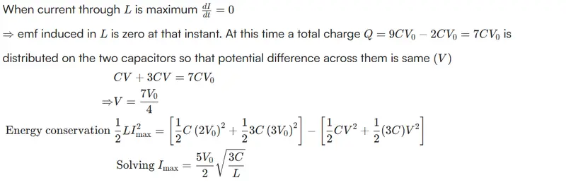

I tried something else
I considered the two capacitors as though they are in series, and combined them into a single capacitor of capacitance 3C/4, and the potential difference between its terminals is ##5V_0##
now, if I apply the standard method,## 1/2 (3C/4)(5V_0)^2 = 1/2 Li_{max}^2##
we get ##i_{max}= 5V_0/2\sqrt{3C/L}## which is the correct ans.
How can this result be explained? is this a coincidence or is it a correct way?
After some thinking, I think I have solved this.
Consider the function for energy of the capacitor system at any time t, where the the charge on the 3C capacitor is ##7CV_0-q## and the charge ##q## on the C capacitor, so the energy ## E(q)= (7CV_0 -q)^2/6C +q^2/2C ##.
When we minimize this function, we get
##q=7CV_0/4##
Hence, ## E_{min}= 49CV_0^2/8 ##
When the energy in the capacitor system is minimum, the energy in the inductor reaches a maximum.
Subtracting this from the total energy of the system we get
## 1/2 Li_{max}^2= 31CV_0^2/2 - 49CV_0^2/ 8 ##
hence we get ## i_{max}= 5V_0/2\sqrt{3C/L} ##

To fill in a step that wasn't immediately clear to me in the solution in post #3: when the current ##i## is at a maximum, the voltage across the inductor vanishes. Applying the Kirchhoff's voltage law tells you that the voltages across the capacitors must add to 0 so that ##V_{C1} = -V_{C2}##. So the potential differences aren't the same, which sounded wrong to me: they differ in sign, which makes more sense.
