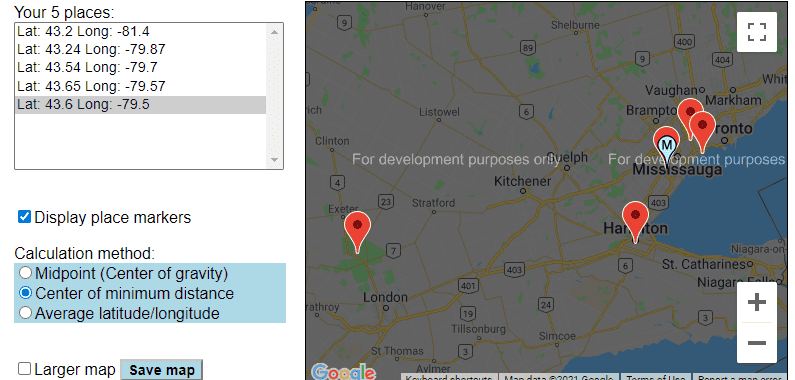

https://www.geomidpoint.com/

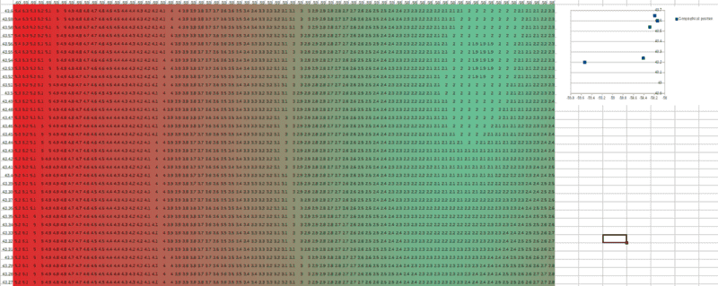

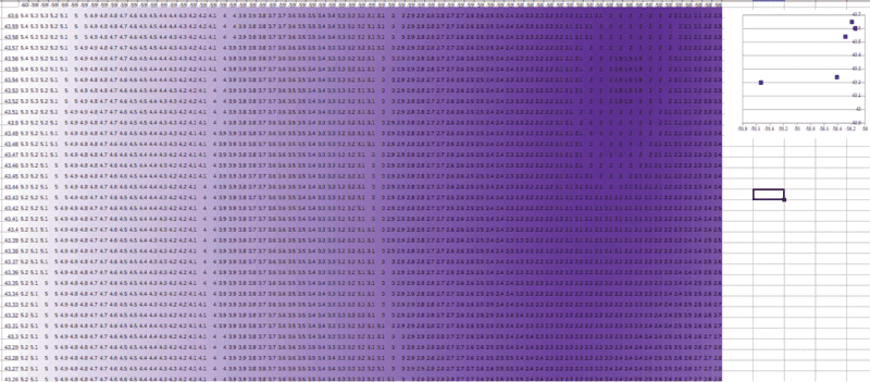

With conditional formatting in LibreOffice and two different color scales:
Note: I scaled longitude with cos(43 degrees) to get a more realistic latitude/"longitude" distance ratio in the calculations but didn't pay too much attention to getting that right for the large table.

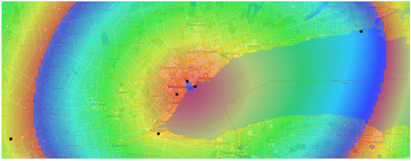

Huh. Well that wasn't nearly as painful as I thought. Took me all of 3 hours in Dynamic HTML and Vanilla JavaScript. Didn't need a library after all (only 44 lines of code).
This is rough and crude and I can add a lot of bells and whistles to it, including generalizing it to accept any number of "houses", but it is operating at full capacity.
It is, alas, as-the-crow-flies, so does not account for roads or speeds - just straight line-of-sight distance.
(Note: the point in the far east is actually two points - two people carpooling from the same location. This skews the centre a little east.)
