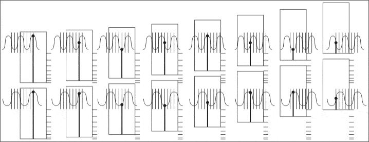

Hi Pervect
I have done up a couple of diagrams which I was hoping to get your input on.
I have looked into the example that is given where light is sent through an elevator that is accelerating. It describes a curved path and this is used to depict the path of light under gravity due to the principle of equivalence.
I have done up some diagrams of this however mine show light as I believe it should be shown; as an oscillation through a point in space; and not as a particle as is shown in the texts.
The results are interesting. Please have a look and let me know if I can say what I think the results show.
One of the interesting results is that mine depicts the red shifting that occurs under gravity whereas theirs don't.

Are you under the impression that say that "light is a wave" means that the light beam itself is moving up and down? That's certainly what you have here implies!

Hmm, well, a falling light beam should blue-shift, not redshift.
I think that what you drew would represent a vibrating particle falling in a Newtonian fashion, at least if I'm interpreting the diagram correctly. What I think you want is to interpret the sine wave as the path traced out by the tip of the E-field vector, i.e
At least that's the only way that drawing light as a sine wave has a physical interpretation that I can think of - by drawing a line connecting the tips of the E-field for a planar wave.
I've changed the orientation due to the limitations of ascii art. If you trace out the tip of the E-field vectors, they trace out a sinusoidal path, but there is nothing physical actually vibrating.
So to model light falling, you need to transform the E and B fields and not imagine a vibrating particle. As I recall, a component fo either field moving in the parallel direction will not change, while a component in the transverse direction will get multipled by gamma.
What this means to your diagram is that if you replace the dots by E-field vectors, the path of the light will change, but you won't see any graphical depiction of the blueshift. The blueshift effect will be a lot more subtle, it will be related to the B-field vectors that you don't even see in this diagram (they are pointing out of the paper), and their relationship to the E-field vectors.
Hi Pervect
Sorry, I didn't mean for it to depict the light particle itself moving up and down. The dots I have shown are just meant to be points on the light itself at equal time slices from each previous one.
As you say it is meant to depict the em as it passes through a point.
I think you are probably right; it probably should be blue-shift.
I've attached another diagram. You will be pleased to see that even as I have depicted it that the two different frequencies would be following the same path.
What do you think about this new diagram? I'm not being a trickster; just seeking your input on it.
Personally I think there is more to it but I will have to think about that.

OK, I wasn't quite sure what the squiggles represented. If your point is just that light appears to fall in a parabolic path onboard an accelerating spaceship (as long as the fall time is short), I agree.
To re-use an old illustration, if you have a horizontally shooting laser gun and an apple, and the apple and the laser gun shoot "at the same time", (as defined by a lightsource midway between them at the same altitude), the apple and the laser beam will hit the floor at the same time.
Note that you have to be a bit careful about time, if you use the coordinate system associated with an accelerated observer not all clocks will tick at the same rate.

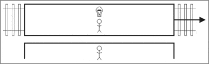

Hi Pervect
That is one experiment I would like to see in action (though I must admit that myself I believe it would be fun to watch for all the wrong reasons; but that's just me).
I must apologise because I reread the wiki page afterwards and realized you were meaning to refer me to the first thought experiment "The train and platform thought experiment" and not that which I thought.
Instead it refers to a train with an observer on the train in the middle and a light also in the middle and an observer on the platform. The light does a flash as the two observers pass each other. I've done a diagram for this one also below. The experiment is about when they see the flashes of that light hitting the front and back of the train. The observer on the train will of course see the flashes as occurring at the same time; but the observer on the platform would see the flashes as occurring at different times.
I think they need to improve it a little as it uses the following confusing wording: "For the platform observer, light moved more slowly toward the back than towards the front...". This gives the impression that they are saying that light is moving slower or faster than itself when they usually state that the speed of light is constant. I know that they don't mean that but would you agree they are using confusing wordage or is it just me?
It is also confusing because with respect to the observer on the platform they say both "the observer on the platform sees the back of the train moving toward the point at which the flash was given off, and the front of the train moving away from it. This means that the light flash going toward the back of the train will have less distance to cover than the light flash going to the front." and "light moved more slowly toward the back than towards the front". Shouldn't it get to the back faster; not slower (according to the idea) as the first quote says but the second seems to oppose?
Also "... the platform observer sees light cover a greater distance to the front of the train, in less time but at the same speed observed by the train observer." If I were to cover twice the distance in half the time I must be going 4 times the original speed; not the same speed? So how do they cover more distance in less time and still get the same speed?
Does this need to be written more logically/correctly or is it just dumb me?
