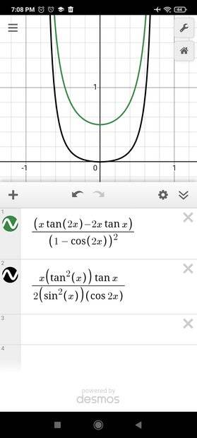

I simplified this function to
##\frac{1}{2} (\frac{x tan^3(x)} {(sin²x)²(1-tan²x)}##
Now further can I not write ##1-tan²x## as ##\frac{cos2x} {sin²x}## ?
If I do that I get ##\frac{1}{2} (\frac{x tan^3(x)} {sin²x cos2x}##
On graphing this on desmos I get two different graphs for these functions
My first simplification matches with the original function but the second one doesnt and hence doesnt fetch me the correct liming value. whys this?

Yes but I dont get why my simplification yields a different function? Is it because the domain has changed of the function?(if it has at all)

Obviously, you made a mistake somewhere. I don't know how you expect us to find the mistake if you don't show us your work.

Evaluate these two at x=0. They are not equal.
I got
[tex]\frac{1}{2}\frac{x}{\sin x}\frac{1}{(2\cos^2 x-1)\cos x}[/tex]
I hope it will help your check.
