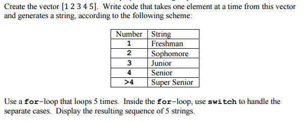

So this is the code i came up with
Code:
%% part 2
  x=[1 2 3 4 5];
  % 1 is freshman
  % 2 is softmore
  % 3 is junior
  % 4 is senior
  % >4 is super senior
  for i=1:5
      s=input('number: ');
      switch s
          case 1
              yearNumber='freshman';
          case 2
              yearNumber='softmore';
          case 3
              yearNumber='junior';
          case 4
              yearNumber='senior';
          otherwise
              yearNumber='super senior';
      end
      disp(yearNumber)
  end
Needless to say, I have absolutely no idea what I'm doing so I'd really appreciate help :)

Hi,
It seems that there is no compilation error (I didn't run it, but looks good) but you did something different from what the exercise says.
You can notice that by looking at the fact that you create a vector x=[1 2 3 4 5] but you don't use it any more, so why do you need to create it?
I think the way to solve this is replace the instruction
Code:
by
Code:
s=x(i);
which means that you are taking the number at position $i$ in the vector $x$ and so you are taking one number of the vector at a time, just as the exercise is stated :)
Thank You! I was confused about where to put that x back in :o But how can I get it to also display "number: x " (whatever x may be) for each case?
Well, I think our code now fits quite good what the exercise says but, if you want to put some text on it, I would do the following.
Inside the for loop and instead of the disp sentence you can write
Code:
fprintf('\n  Number: %8i\n', yearNumber)
frpintf do more or less the same than disp, but have a few more options.
The ' ... ' means that there is an string inside.
\n is for writing in a new line.
And %8i is a declaration of the type of the next argument yearNumber, which in this case may be displayed as an 8 characters integer. (The italics aren't exactly correct, but you can think on it that way)

This is what Matlab gave me
Oh sorry, I mixed up what was going on.Instead of %8i you should write %s since yearNumber is not an integer, is a string. (So you want to wirte things like Number: Junior ?:confused:)
Anyhow I don't know why you have 10 sentences instead of 5, I don't have Malab right now so I can't run the program.
My recommendation for you is to debug the program and run it step by step in order to see what Matlab is writing on. Try to do it, I will try to come back to this thread when I get Matlab again if you can't solve it.
