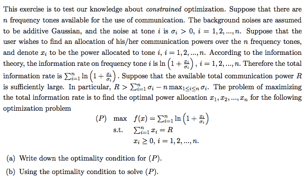

Printed text of a constrained optimization exercise on allocating communication power over n frequency tones, with the maximisation problem P and parts (a) and (b) listed.
There is a typo in the problem, ”R > Σ n i=1 σi − n max 1≤i≤n σi” which should be R > n max (1≤i≤n) σi − (Σ n i=1 σi )

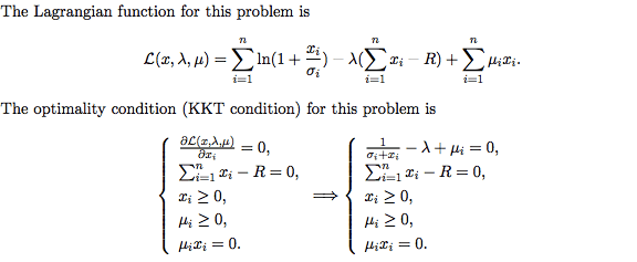

Lagrangian function L(x, λ, μ) = sum over i of ln(1 + x_i/σ_i) minus λ(sum of x_i minus R) plus sum of μ_i x_i, followed by the KKT optimality conditions as a system and the simplified system with 1/(σ_i + x_i) − λ + μ_i = 0.
Not sure where to go with part B or where to start...
