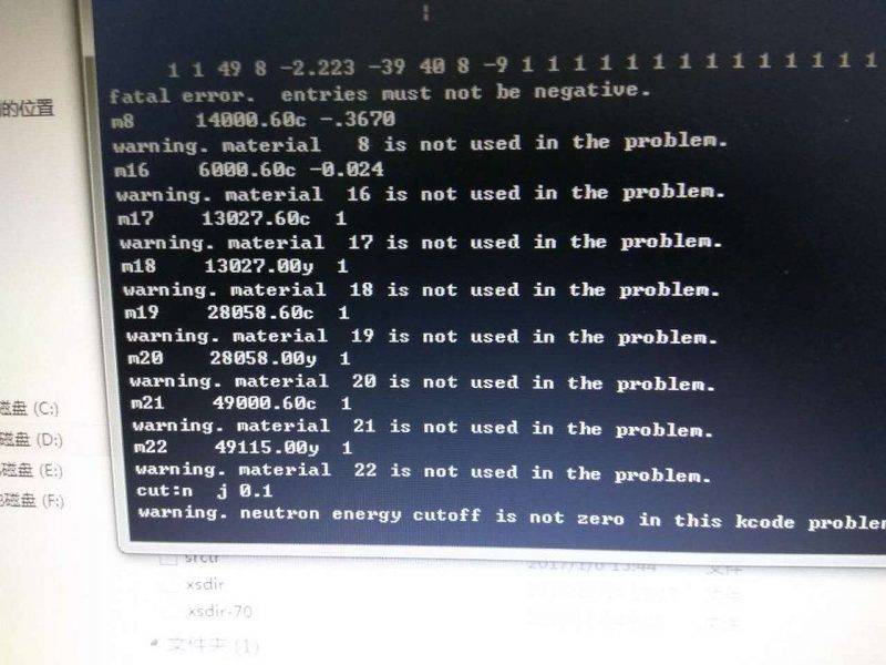

ISAAC BAIDOO Messages 4 Reaction score 0 Thread starter Jan 6, 2017 #1 i am trying to run my mcnp input file and these are the error messages which i do not no how to fix them.

jedishrfu Mentor Insights Author Messages 15,835 Reaction score 10,722 Jan 6, 2017 #2 As a general practice try to fix the first error and run again as subsequent errors may be a result of the first error and the programs desire to continue to the bitter end.

berkeman Admin Messages 69,828 Reaction score 25,770 Jan 6, 2017 #3 Yeah, looks like the main problem is that you have negative numbers in your input data, and the program does not seem to like that...
