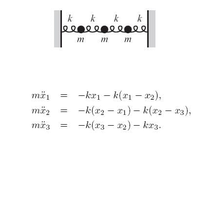

hi, sorry for my bad english, i need to three mass and four spring ode equations,
this system: wall -- spring -- mass -- spring -- mass -- spring -- mass -- spring -- wall
but i need this system that has damped, because i have this system equation that undamped,
please help me soon, i need damped equation soon, thanks to all :!)
People cannot read your mind! There are many possible "damping" functions, most often linear or quadratic but can have almost any form. You probably want the simplest, linear, which is of the form [itex]-\nu(x_i)'[/itex] where [itex]\nu[/itex] is the "damping coefficient". Put one of those into each equation.
thanks
