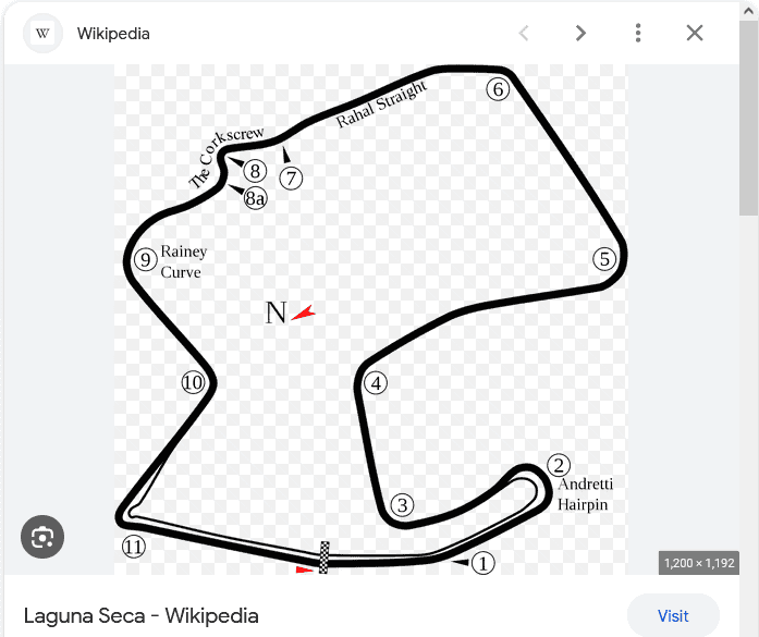

I was riding a track day at Laguna Seca in Monterey one time when the wind was very strong. It was not too bad on most of the places on the track, but at the top of the hill between turns 6 and 7 there was a section of the track where the side hill dropped away and the wind was howling across the track left-to-right. I had to lean my sportbike pretty hard to the left to stay on line to set up for the corkscrew -- it was a very strange sensation (especially at 80+mph at that part of the track).
https://en.wikipedia.org/wiki/Laguna_Seca

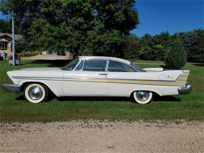

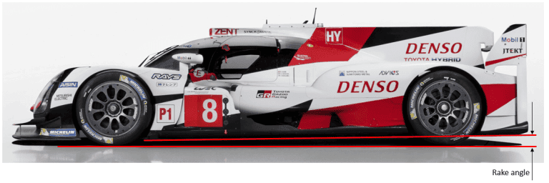

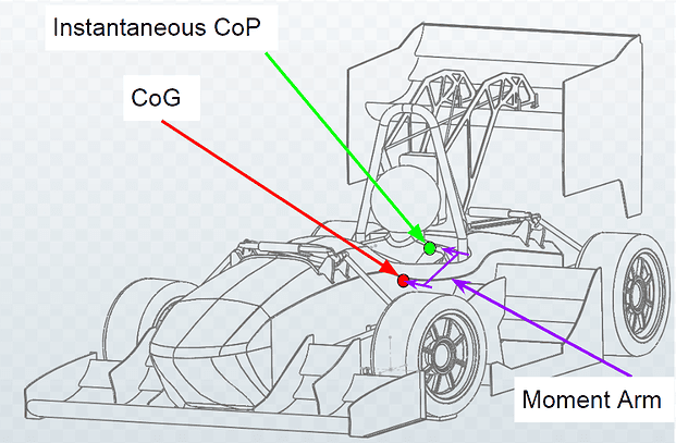

Yes, it does. It has to do with the position of the Center of Pressure (CoP) vs the center of Gravity (CoG). When the CoP is behind the CoG, the vehicle steers into the wind, correcting itself automatically, thus making the car very stable. When in front, it steers away from the wind, making the vehicle very sensitive to side winds.
With side winds, of course, the side view area is the important factor, not the frontal area. That is why race cars have these large tail fins at the rear.
This effect was also confirmed with cars with large tail fins in the 50's:
