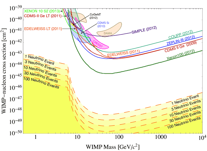

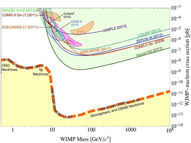

The proton recoil (or, more likely, electron or nucleus recoil) could still lead to scintillation. Dark matter detectors use similar detection methods, and the neutrino background will become important in a few years.

ChrisVer said:
@mfb I guess you mean the plots like this
https://inspirehep.net/record/1261376/files/sd_proton.png
which are approaching in sensitivity the region to detect the neutrino background?
The approaching neutrino background can be seen here:
From http://inspirehep.net/record/1243804
The exclusion limits got better since 2012. For the low-mass region, see this plot taken from the CRESST paper discussed there. Just an order of magnitude to go in the 7-10 GeV mass range. Include experiments currently running or under construction and some neutrino events should appear. There was a talk at the Moriond conference how to exceed searches below that limit by doing more careful analyses in terms of energy spectrum or directional detectors. Oh wait, the topic of this thread were neutrinos ;), they will be a relevant background soon.
Today's signal, tomorrow's ... Well, you know.
