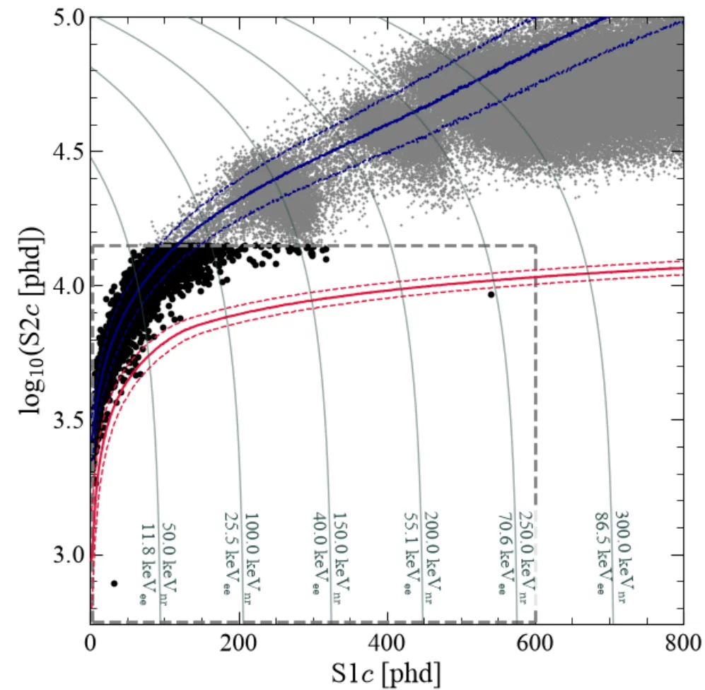

The main plot (slide 18):

What are these units of [phd] in the graph?
Never heard of this measure..
'photons detected'
The linked paper explains this in detail.
PhDs students expended photons detected.
S1 is the prompt signal and S2 is the delayed signal.

Any chance we could get a 5-year old's understanding of what we're seeing here:
My questions - and my updates from browsing, in blue:
  1. What are the axes?
    - phd = photons detected
    - "Position-corrected values, denotedS1c and S2c, allow for scale factors to correlate the signals to the original number of photons and electrons produced."
  2. What is the red line?
    "..represents the NR ... band ..." [Neutron Recoil? Non-Relativistic?]
  3. Is the datapoint of interest the one in the upper right of the dashed box? Or the lower left perhaps?
    "The event of interest appears at (540.1phd, 103.98phd) [i.e. upper right outlier]. The event below log10(S2c)=3 [i.e. lower left outlier] is consistent with accidental background..."
  4. Can I assume the vast majority of data points are observations from zillions of tests representing the gamut of mundane results?
    "...Black points show the WIMP search data from the full "science" sample which pass all data selections and are not tagged by the veto detectors..."
mfb said:
I got fed up... :-p
AI summary of Fig 4:
Figure 4 displays the WIMP search data from the full science sample in the LUX-ZEPLIN (LZ) experiment, plotted in the space of corrected prompt scintillation signal (S1c) versus the logarithm of the corrected delayed electroluminescence signal (log10(S2c)). Key features of the figure include:
  1. Data Points and Regions:
    • Black points represent events passing all data selections and not tagged by veto detectors.
    • The dashed gray line outlines the WIMP search region of interest (WS ROI).
    • Red and blue lines indicate the nuclear recoil (NR) and electron recoil (ER) bands, respectively, as defined by calibration data.
  2. Event of Interest:
    • A single event stands out in the NR band at (S1c = 540.1 phd, S2c = 9268 phd) [upper right outlier], corresponding to a reconstructed nuclear recoil energy of 248 ± 23 (stat) ± 23 (sys) keV.
    • This event is 1.5σ below the median of the NR band and 6.7σ below the median of the ER band, making it highly NR-like and unlikely to be an ER background.
  3. Backgrounds and Features:
    • The event below log10(S2c) = 3 is consistent with accidental background.
    • Spectral features in the ER band above 25 keVee are mainly due to 125I and 133Xe decays, which appear slightly below the beta-decay ER band because of increased recombination from Auger cascades.
  4. Interpretation:
    • The figure visually demonstrates the separation between NR and ER events, with the event of interest clearly isolated in the NR band at high energy, where background rates are low.
    • This supports the statistical significance of the observed event as a potential dark matter candidate or a rare background process.
Overall, Figure 4 highlights the exceptional nature of the observed high-energy nuclear recoil event in the context of the experiment's background and signal expectations.
DaveC426913 said:
I got fed up... :-p
FWIW this AI description matches what I was able to pull from the detector description in the paper. The Xe gives off light if a Xe nuclei collides with something. The entire Xe detector is surrounded by other detectors that reject backgrounds like neutrons and charged particles from the data. I’ve always wondered how detecting something like a WHIMP would work. This is actually quite direct.
