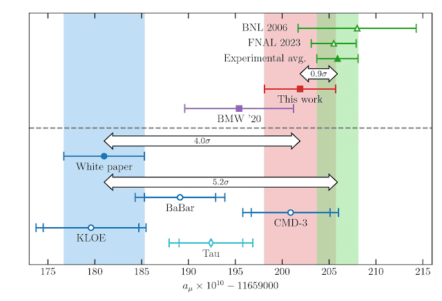

Horizontal error-bar plot of muon anomalous magnetic moment values (a_mu x 10^10 - 11659000) from 175 to 215, comparing experiments, lattice results, and data-driven estimates.
The updated BMW calculation of the hadronic vacuum polarization contribution to the muon anomalous magnetic moment aμ in the Standard Model is squarely consistent, at 0.9 sigma with the experimental measurement of muon g-2.
This agreement is found to be present despite the fact that its uncertainty in this new and improved HVP calculation is 40% smaller (producing a 31% reduction in the uncertainty of the overall theoretical calculation) and the fact that the 2023 experimental measurement has 55% less uncertainty, making agreement of the two values a harder to hit target.

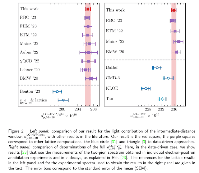

Figure 2 with two dot-and-error-bar comparison panels of hadronic vacuum polarization values a_mu x 10^10 from lattice and data-driven determinations, with a shaded red band marking the reference value near 236.
The apparent discrepancy between the Theory Initiative calculation of the Standard Model prediction and the experimental results has been the source of countless papers proposing proposals for new physics.
This discrepancy was a result of an inaccurate calculation of the Standard Model prediction for muon g-2 by the Theory Initiative. This was mostly a result of the incorporation of slightly inaccurate experimental data (regarding electron-positron annihilations that produce pion pairs) into their hadronic vacuum polarization calculation. Their source for the experimental data that it used, despite the source's good faith efforts to estimate the uncertainty accurately, understated the uncertainty of that experimental data by roughly a factor of four (as revealed by the spread of the results of subsequent experimental measurements of the same phenomena).

New BMW calculation (2024): 116,592,019(38)
BMW calculation (2020): 116,591,954(55)
Theory Initiative calculation (2020): 116,591,810(43)
World Experimental Average (2023) : 116,592,059(22)
Fermilab Run 1+2+3 data (2023): 116,592,055(24)
Combined measurement (2021): 116,592,061(41)
Brookhaven's E821 data (2006): 116,592,089(63)
