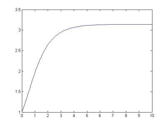

I hope they have the theorem which state that this method is always stable. I will try later to write a MATLAB script later to see what result this method gives. Has anyone seen the analytic solution for
[tex]\frac{dy}{dx} = \sin(y)[/tex]
before?
I have written the MATLAB script. If only I know the analytic solution to compare.
% Solving IVP y'=sin(y) , y(0)=1
% Using Euler Backward Method
h=0.1; % step size
y(1)=1; % MATLAB index start from 1. y0=y(1)
xi=0; xf=10; % domain [xi , xf] num_pt=(xf-xi)/h+1 = 101
for n=2:101
y(n)=y(n-1)+h*sin(y(n-1))/(1-h*cos(y(n-1)));
end
x=xi:h:xf;
plot(x,y)
