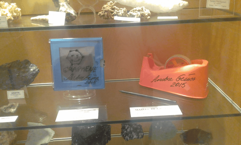

A visual inspection of the device also shows that the capacity for upscaling is very limited.
