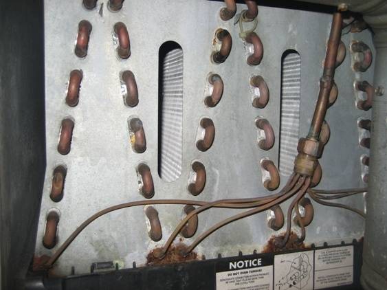

No I haven't done that. There's probably nothing in the system right now anyway. The coils are pretty corroded but I'll get a camera and post a pic in a few minutes.
Picture of the coils. Quite a bit of corrosion and there is a dent on a coil (second from bottom left). If the lines test out OK, I'm pretty confident that the coils are what's been leaking. An actual leak test from a contractor would be about $300 to $500 which is probably a waste of money at this point. I'm really tired of trying to keep this dinosaur living each year.
Indoor coils.. copper with aluminum fins... get some Mr Bubble kids' bubble-bath and apply to the fittings. And around bottom where copper comes through that rust.
Especially on outside unit where the pressure ports are .
Good luck !

I put some on the fittings and ran the system for a bit. I didn't see anything.
a hidden leak.. They can be hideously difficult to find.
sorry about that..
