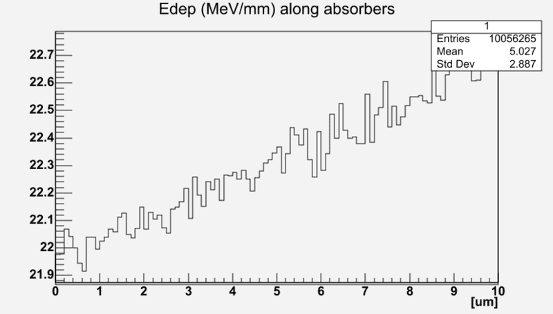

Step-style line plot titled Edep (MeV/mm) along absorbers, energy deposition from about 21.9 to 22.7 MeV/mm against depth in um from 0 to 10, rising overall with fluctuations; ROOT statistics box shows Entries 10056265, Mean 5.027, Std Dev 2.887.

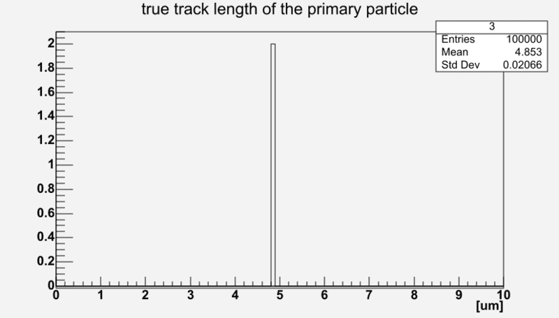

ROOT histogram titled 'true track length of the primary particle', x-axis in um from 0 to 10, y-axis counts; a single narrow bin near 4.85 um reaches about 2, with stats box Entries 100000, Mean 4.853, Std Dev 0.02066.
These are my result graphs in geant4

So, what I've written might contain mistakes, and it's simplified and not exactly what you asked for. I've added an energy bin tally between 4.4 and 4.8 MeV. The peak corresponds to a stopping power of around 34 MeV/mm. I don't think X has the capability to plot energy loss versus true distance.
I found some fairly old tables here and Chromium is missing, so I tried the numbers for Vanadium and got a result of 33.7 MeV/mm. I'm pleased, if slightly weirded out by the match. It seems a bit too good to be true. I don't know why your numbers are 2/3rds of this. I hope the attached output is of some help.

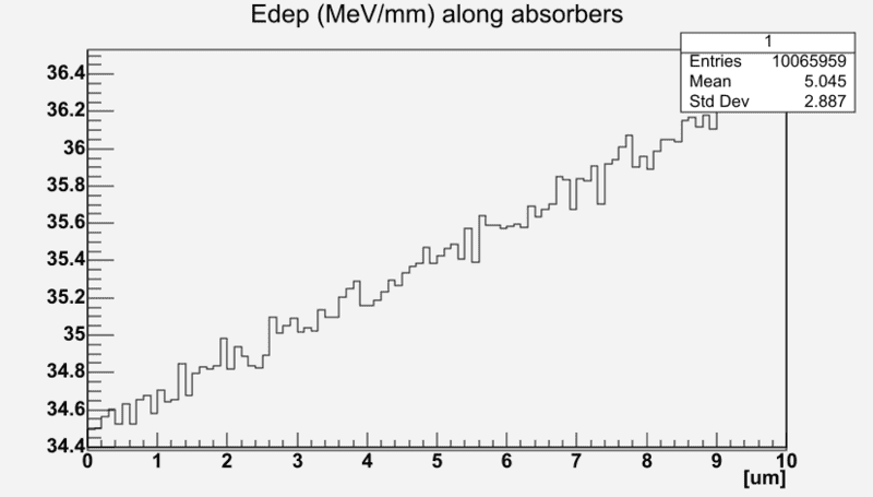

Sorry, I did the experiment for germanium in geant4. That's why our data do not match.
Line histogram titled Edep (MeV/mm) along absorbers, energy deposition rising roughly linearly from about 34.5 at 0 um to about 36.1 at 9 um, with a statistics box listing 10065959 entries, mean 5.045, std dev 2.887.
