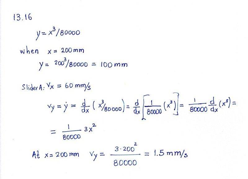

This is Pytels Dynamics 2nd edition problem 13.16
13.16. Pen P of the flatbed plotter traces the curve y=x3/80000, where x and y are
measured in mm. When x=200mm, the speed of slider A is 60 mm/s. For this position, calculate
(a) the speed of P; and (b) the normal component of the acceleration of P
Diagram of a flatbed plotter mechanism: a curve y = f(x) rising to the right, a pen P at a point on the curve, a vertical arm with a pin passing through a horizontal slot, and a slider A on a horizontal rod along the x axis.
Handwritten solution to problem 13.16: y = x^3/80000, at x = 200 mm gives y = 100 mm; slider A v_x = 60 mm/s; v_y = dy/dt = (3x^2/80000) dx/dt, which at x = 200 mm gives v_y = 1.5 mm/s.

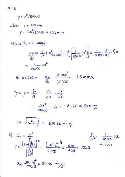

In part (a) I don't get 108.2 mm/s for the speed. what am I doing wrong?
##\dot y## is the derivative of ##y## with respect to time. You took the derivative of ##y## with respect to ##x##. Hint: chain rule.
That look's correct. Nice work.
