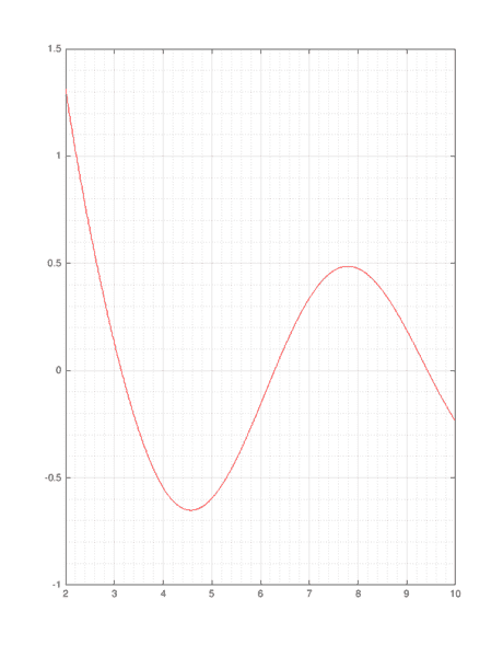

Hi I want to plot the function ##y=\sin(x)/\log(x)## in MATLAB but I get the next error message:
Matlab:
Warning: Imaginary parts of complex X and/or Y arguments ignored
Here is the script that I used:
Matlab:
x = -2*pi:pi/100:2*pi;
y = sin(x)/log(x);
plot(x,y)
How to fix this that I'll get the plot on the real line?
Thanks!

@jedishrfu when I try to plot for the domain [2,10] I still don't get a graph, I do get the plot window but without the graph line, it doesn't show up.
Matlab:
x = 2:1/100:10;
y = sin(x)/log(x);
plot(x,y)
Use this:
Matlab:
y = sin(x)./log(x);
The thing I added is "./" so that ##y## becomes a matrix. Now you should get a good plot.

the dot before the operator says to do an element by element evaluation.
as an example:
x=0:0.1:10
y=x.*x
generates the y=x^2 function and this plots it
plot(x,y)

Note that the dot also works for exponential operators:
Code:
y = x.^2
