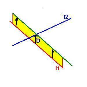

If you shift one of the lines in the direction along the common normal vector with the distance of the skew lines, it will intersect the other line. That shift means adding or subtracting D=3n to the parametric form of the line. The point of intersection is that point which is at shortest distance from the other line. The point of intersection defines both parameter values, so you get the points on both lines which are closest to each other. I try to explain it with the drawing attached. The black D vector is the normal vector times distance.

  • Diagram of two skew lines in perspective, l1 in red and l2 in blue, with a yellow strip between them, arrows marking direction, and a vertical segment labelled D showing the shortest distance between the lines.

As there is no answer from the OP I try to give more help. The unit normal vector of both lines is (as given by the OP) n=1/3 (-i+2j-2k), and the distance of the lines is 3. When he parametric form of line 2 is r2=-2i+2k+s(j+k), adding (or subtracting) 3n results in a new line parallel with the former and at distance 3, which must intersect line 1. r3=r2+3n=-3i+(2+s)j+sk. If the equation of line 1 is r1=i+j-3k-p(2i+2j+k)=(1-2p)i+(1-2p)j-(3+p)k, it has to intersect r3:-3i+(2+s)j+sk=(1-2p)i+(1-2p)j-(3+p)k Comparing the components, -3=1-2p, 2+s=1-2p, s=-(3+p) This system of equation is solvable, so the lines intersect: we get the values for p and s, and substituting for p into the equation of line 1 we get the point which is closest to line 2.
