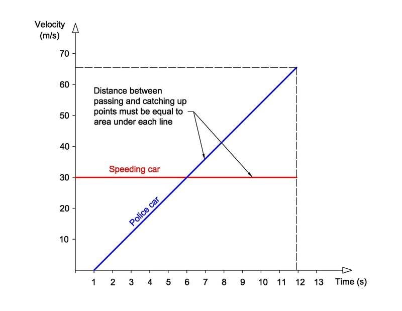

Lnewqban said:
I couldn't make sense of the text box.
Do you mean, when the police car catches up, the areas under the lines that are to the left of that time are equal?
Sorry, my English is poor.
Yes, that is the idea I tried to bring to the attention of @Ineedhelpimbadatphys .
The distance and the time between the two points at which both cars meet (pass and catch up) are unique for both, IMHO.
I can modify the diagram later following your advice.
