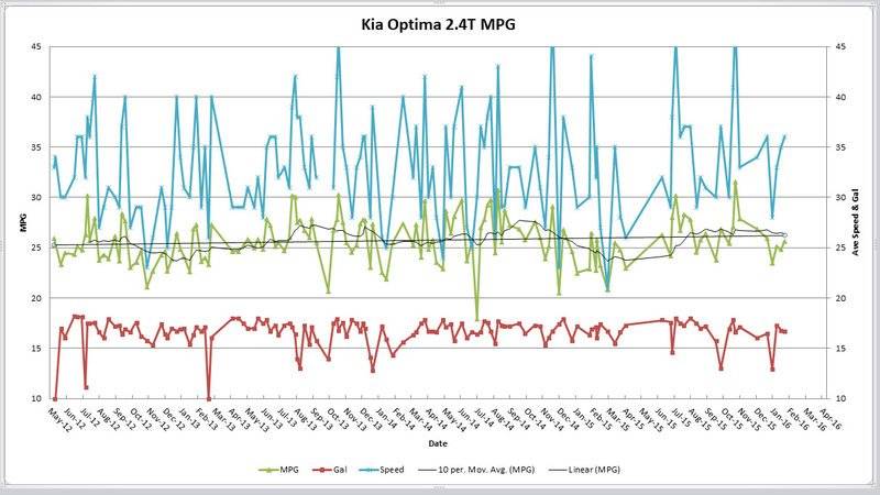

So I looked back at the data and it is actually closer to 3 years. Here it is:
Notes:
  • I used odometer miles and fill-up gallons. I have an ODB II scan tool permanently mounted on the steering column, which gives me "current trip" (resets when you start the car) and "tank" data including mpg and ave speed. The mpg is from the odometer and gas fill-ups.
  • Very low signal to noise ratio for trying to spot trends, except one:
  • Strong correlation between mpg and average speed.
  • The linear trend showed I gained 1mpg over the three years, from an 25-26 mpg ave.
  • There is a distinct seasonal variation in the moving average, of about 3-4 mpg peak to trough.
  • There is no winter drop-off in 2016, likely due to me getting a project 180 miles away and traveling there a handful of times that winter.
  • I feel like there is a difference in mpg between "warm" and "hot" weather, but can't prove it from this data.
  • A confounding factor on the seasonal average is two 30 mpg peaks adjacent to each other in June of 2013 (and repeating after that) must be the first year I drove 7 hours for my summer vacation.
  • I get between 400 and 550 miles per tank; It's an 18 gal tank and I run it near dry before filling.

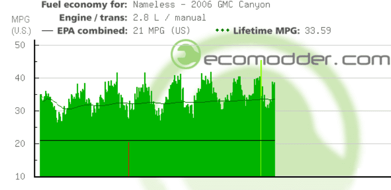

Here's the fuel economy chart for my truck for the last 8 years:
It clearly shows the difference between summer and winter. In fact, a ten degree F temperature change is almost exactly 1 MPG. Winter 2017-2018 mileage was worse than normal because almost all driving was in colder than normal temperatures with headwinds.
