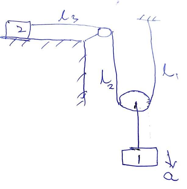

In the following mass pulley system what would be the relationship between accelerations of blocks 1 and 2? Assume acceleration of block 1 is ##a## downwards, so that ##a## denotes the magnitude of acceleration of block 1.
None
Assume that the lengths of various sections of the string at an instant are as shown. So we can say that
##l_1 + l_2+l_3= k## at an instant of time ##t##, where ##k## is a constant.
Taking the second derivative of both sides w.r.t. ##t##, we get $$\frac {d^2{l_1}} {dt^2} +\frac {d^2{l_2}} {dt^2} + \frac {d^2{l_3}} {dt^2} = 0$$.
After above step, I'm stuck. I know the second and third terms in LHS will be each equal to ##a##.
$$\therefore \frac {d^2{l_3}} {dt^2} = -2a$$.
I need to now prove that LHS is negative of acceleration of block of 2. How will I prove that?

vcsharp2003 said:
Homework Statement:: In the following mass pulley system what would be the relationship between accelerations of blocks 1 and 2? Assume acceleration of block 1 is ##a## downwards, so that ##a## denotes the magnitude of acceleration of block 1.
Relevant Equations:: None
What do you mean? This depends on which direction you state as positive for the acceleration of 2.
As time goes by l_3 is shortened or decreasing with accelerated pace. Shortend means signature minus.
The problem I'm having is how can block 2 have a negative acceleration. I cannot find any meaning in the acceleration of block 2 being negative. ##a## is positive since it's the magnitude of block 1 acceleration.
##l_3## is shortened with time and therefore the first derivative of it is negative. That I get. But now, how will I know whether second derivative of ##l_3## is positive or negative?
Again, this depends on what direction you define as negative. If ##a## is positive and you define the positive direction for 2 as the direction of growing ##\ell_3##, ie, 2 moving to the left, then the acceleration of 2 is negative. If you define it the other way around it is positive.
I have taken ##l_3## as distance from the pulley to block 2. So, its as if I took the positive x-axis to be pointing leftwards with its origin at the pulley fixed to table. Since we know the block 2 will move towards the right i.e. in negative x-axis direction, so its velocity i.e. first derivative will be negative, and also acceleration will point in negative x-direction so its second derivative will also be negative. That is the meaning of second derivative coming out to be negative. Does that sound right?

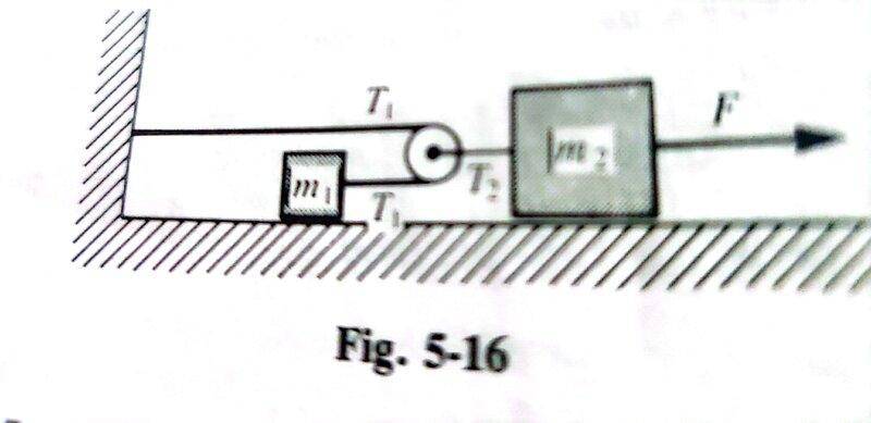

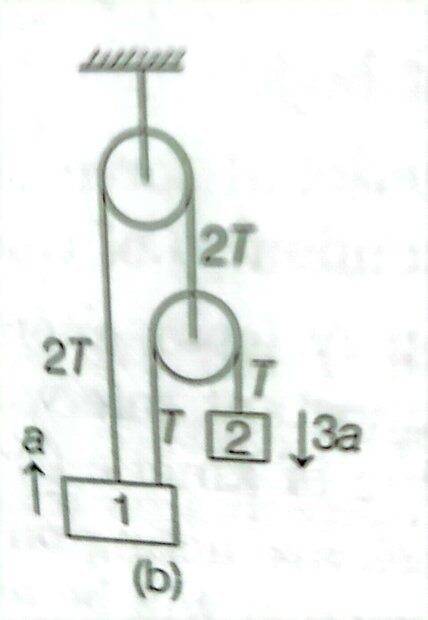

Could we also say the following as an alternate method to get the acceleration relationships? Someone mentioned to me that this is a quick shortcut approach to getting the acceleration relationships.
Since block 1 experiences a tension of 2T if block 2 experiences a tension of T and also acceleration can be considered inversely proportional to the tension on the block, so block 2 has an acceleration that's half the acceleration of block 1.
Right so far, then
Whoops!
haruspex said:
Whoops!
But, it works in this situation and other pulley mass systems. I have tried it in other pulley mass systems and surprisingly it always gave the correct acceleration relationships. But, don't know why it works consistently across various pulley mass systems.
I applied it to two mass pulley systems and it worked giving the correct acceleration relationship. In first system ##2T_1 = T_2## so acceleration of ##m_2## is half the acceleration of ##m1##.
As I responded in post #9, your inversion principle is fine, but you did not apply it correctly.
You wrote "block 1 experiences a tension of 2T if block 2 experiences a tension of T". So does block 1 experience half the acceleration or twice the acceleration?
I said block 2 experiences twice the tension experienced by block 1 since ##2T_1= T_2##. So block 2 acceleration will be half that of block 1
UPDATE 1: Sorry, you're right. I was thinking about the later post# 10 when I wrote the above para. In my orginal question diagram, block 1 would experience half the acceleration of block 2 since block 1 experiences twice the tension that block 2 experiences.
haruspex said:
Right so far,
Why this quick shortcut works is still a mystery to me but it sure helps arriving at the relationship between accelerations very quickly.
It is effectively conservation of energy.
It seems like you just forgot to assume a convention for block 2.
let's say its this ## \rightarrow^+ ##
The other bits are fine:
$$ \ddot{l} = \ddot{l_1} + \ddot{l_2} + \ddot{l_3} = 0 $$
$$ \ddot{l_3} = - \left( \ddot{l_1} + \ddot{l_2} \right) $$
$$ \ddot{l_1} = \ddot{l_2} \implies \ddot{l_3} = -2 \ddot{l_2} $$
Now you need to examine free body diagrams of each block under the assumed convention. If you correctly set those up the directions should remain aligned with the convention.
I get the following equations from the FBD's
$$ m_2 \, \ddot{l_3} = T $$
$$ m_1 \, \ddot{l_2} = m_1 g - 2T $$
Ok, that's very interesting. Is it like equating the work done by the tensions? Equating in my orginal question, we would get ## T \times s_1 = 2T \times s_2##, where ##s_1## and ##s_2## would be the displacements of masses ##m_1## and ##m_2## respectively. So, displacement of ##m_1## would be twice the displacement of ##m_2## in the same time interval, and therefore, we could say acceleration of ##m_1## is twice the acceleration of ##m_2##, provided we assume that eac mass experiences a uniform acceleration that remains constant with time.
Is this what you meant?
UPDATE1: I think the net work done by tensions on masses should be zero. This is because the total energy, which will KE + GPE of the masses at two different instants of time remains the same since we are ignoring any friction resistance that may otherwise exist in a real situation. Thus individual work done by tensions on each mass must cancel out i.e. +ve and -ve tension work would cancel out.
I'm second guessing myself!
When I'm solving this I'm getting
$$ \ddot{l_2} = \frac{m_1}{m_1- 4 m_2} g $$
That can't be right!
I expect:
$$ \ddot{l_2} = \frac{m_1}{m_1+ 4 m_2} g $$
Seems like this is the system:
$$ m_2 \, \ddot{l_3} = -T $$
It seems like we have to account for the direction of ## \ddot{l_3} ## as negative to get there... for some reason its seeming like there is maybe some unnecessary steps in my approach? Because isn't it the case that we shouldn't have to correctly assume how this thing evolves, but rather be told how it evolves by the solution given our assumptions?

The mistake you committed was a very subtle mistake. With your axis system pointing right with origin at the table pulley, we know that the coordinate ##l_3## is negative and therefore the horizontal distance along table of string is ##-l_3## since distance must always be +ve. Now our initial equation becomes ##-l_3 + l_2 + l_1= k##. This would then give you the correct values with correct directions.
Remember we must always take coordinates and not distances when we use an axis system in kinematics. I also committed the same mistake in my analysis of taking distances in my original post and that's why I was also very, very confused. It's good you pointed out this issue which helped clarify a key concept when using axis system in kinematics.

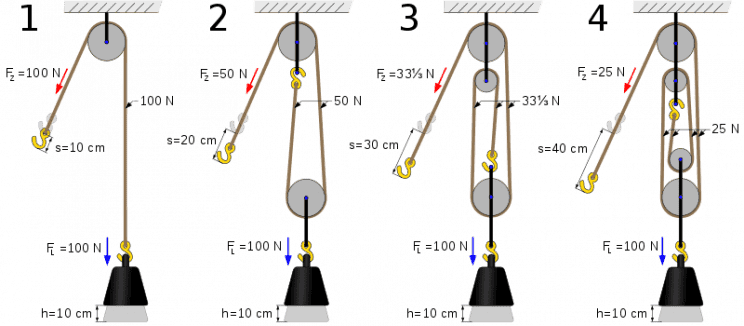

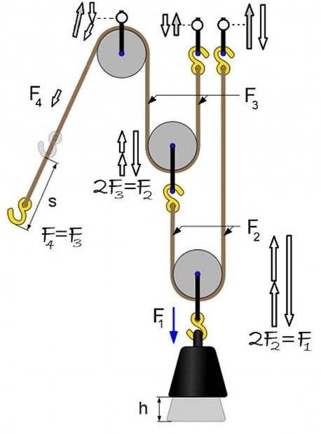

Copied from
https://interestingengineering.com/machine-design-101-pulleys-and-counterweights
"An example of a compound pulley system that has the force equations labeled and written out. Closely examine all of the different equations to get an idea of how pulley systems are modeled mathematically."
Diagram of a compound pulley system with four pulleys and a hanging weight, with force labels F1, F2, F3 and F4 and relations 2F2 = F1, 2F3 = F2 and F4 = F3, plus a displacement s and height h.
:cool:"An example of many different pulleys and the forces that are involved in each design. You can see that as more pulleys are added, the less force that is needed to move the block the same displacement. However, the distance that force has to be applied over is also longer."
Four panels numbered 1 to 4 showing pulley systems lifting a 100 N load 10 cm, with pulling force F = 100 N, 50 N, 33 1/3 N and 25 N and rope displacements s = 10 cm, 20 cm, 30 cm and 40 cm.
