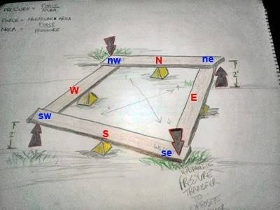

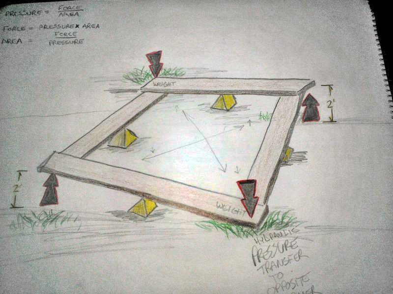

I would love to hear your feedback on this picture guys. I'm not an engineer, but I drew this several years ago as part of an invention idea (hydraulic fluid used to spin a turbine, energy conversion). I've gone WAY past this in my invention, but, my partner and I revisited my sketch book for an addition pertaining to this drawing. We could have built it in less time than we debated it. He insists the picture is drawn wrong and it wouldn't work. It hurts my brain. Thoughts?
Adjusted for clarity.
I have no idea what 4 fulcrums and 4 planks of wood have to do with spinning a turbine. I know it doesn't matter to this sub-problem, but you haven't defined what this sub-problem is. What's it supposed to do? You ask if it "works". What works?
Will the left and right corners go up? Depends. The connections between the planks, are they rigid, or will they flex?
The picture is a machine. Applying pressure to corner moves the machine; or at least that's the theory. As a side note, which is irrelevant to the drawing, we are working with compressed fluid flow (fluid dynamics) to transfer hydraulic pressure into electricity.

Bottom left corner... if you walked up to that and stepped on it what would happen? Assuming ofcoarse that the boards were hinged or connected in some way, shape or form.
You'd tear the nails out of the boards at the connection points. Or are the connection points flexible? Are they even connection points? Maybe the boards are just lying on each other.
Let me assume they are simply lying on each other. That means the boards can move with respect to each other.
I see now. Yes. Both weights would lift. But the near weight would not lift as high as the far weight.
Lets assume the boards are connected a door hinge, rope or cable. Yes, something flexible to allow the machine to move.
It would work. Your friend is mistaken (assuming I have the starting move correct: i.e. stepping on point sw).
Stepping on point sw would pivot W.
That would raise nw and the weight on it.
Raising nw would pivot N, dropping ne.
ne would push down on E, causing it to pivot.
E pivoting would raise se, and the weight on it.
Stepping on S would also raise se, and the weight on it.

That's what I said! But he insists that the machine would only rise one foot, not the two feet as drawn. The machine would be even on all four sides.
If the four boards were replaced by four fluid tanks (or for this scenario four 5 gallon buckets connected with pipe on the bottom), according to him, it would take 3x more energy to lift the corner back up as well. We argued it for 4 hours lol. I might just build the damn thing to alleviate any doubt.

He's not here to defend his stance, so I'm not about to say categorically he's wrong - there could be many unspoken assumptions. But, as-drawn the weights would rise 2 feet.

I think the reason why you are having so much trouble agreeing with him is the same as why the posters in this thread are having so much trouble helping you: you are providing shockingly little information on which to base any conclusions about what happens. You have great art skills, but you are not engineering your "invention".
An additional piece of information needed: how tall are the fulcrums?

I think it is a safe one though: before the device is even activated, we know the fulcrum must be at least one foot high. Which means after activation, the low points will rise at least two feet.
If the assumption is in error, it errs in favour of the device lifting even higher than 2 feet.
