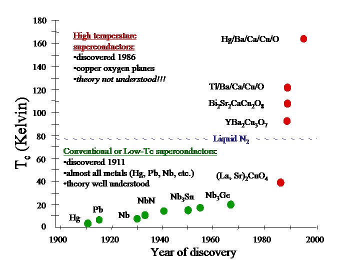

I will admit to first being exposed to the term "room temperature superconductivity" during a pop-sci Michio Kaku interview. However, I was wondering, just what do the scientists who actually work in the field think of the possibility of room temp sc occurring in our lifetime?
Also, do you think we'll achieve highest Tc above 138 K this year?
And, when will we HTS wires that aren't brittle metal oxide ceramics?
If you'd asked this question in the early 80's the answer would be, "Oh, in about 500 years, if we're really, really lucky !"...and then there was the Cuprate revolution. Now, the Tc vs time curve is leveling off again, and barring another materials revolution - the kind that you can't predict in advance - the prospects of finding a room temperature Tc in the next few decades appear low.
