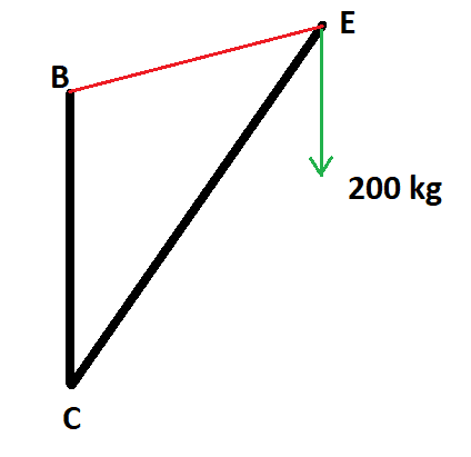

Find the cable tension and the compressive force in the beam
Equilibrium means sum of forces equals zero
For this problem we are asked to find the tension in the cable BE and the compressive force in beam CE. We are given that ## \angle C = 40 \circ##. We are also given that CE = 10 meters and vertical BC = 6 meters.
My solution is to find BE using the law of cosines, from which I get
$$BE = \sqrt{10^2 + 6^2 - 2(6)(10)cos(40)} = 6.638875 m$$
I use the law of sines to calculate the angle E (taken as CEB) as
$$ \angle E = sin^{-1} \left ( \frac{6sin(40)}{6.638875} \right) = 35.51602 \circ$$
Now the sum of the forces in the x direction at point E is just (note the angle from the mass to E to B is 75.51602 degrees):
$$-F_{BE}sin(75.51602) + F_{CE}sin(40)=0$$
and the sum of the forces in the y direction is:
$$-F_{BE}cos(75.51602) + F_{CE}cos(40)=200*9.8$$
When I solve this I get that the cable tension is 2168.7 N and the compressive force in the beam is 3266.7 N. The textbook has a value for the cable of 2450 N and the beam of 3360 N. I am not sure why my solution is wrong.

I did a quick check and get the same as you, I guess the official answer is wrong - it sometimes happens.
Also, note if you are using g=9.8m/s², the answers should be rounded to two sig. figs. =- you can get away with three, but five is too many!

Thanks. If you did the problem and got my answer then I guess the book is wrong. I generally include the amount of figures that looks good to me. The "significant figures" rules never made much sense to me.:cool:
It gets a lot closer to the given answer if we take 40° as the angle to the horizontal, but still a bit off - about 2% too high. Making g 10 instead of 9.8 doesn't help as that adds another 2%, not subtracts it.
I strongly recommend working entirely symbolically until the end. Create variable names for all the given numbers. It has more readable, checkable, correctible and often less work with a more accurate answer.
