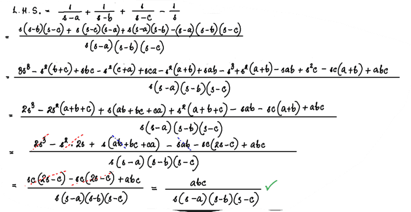

Attempt : I can sense there is an "elegant" way of doing this, but I don't know how. I show below my attempt using ##\text{Autodesk Sketchbook}##. I hope am not violating anything.
Handwritten derivation simplifying 1/(s-a) + 1/(s-b) + 1/(s-c) - 1/s to abc over s(s-a)(s-b)(s-c), with a green check mark at the end.
Ok so I have got the answer, with clumsy algebra and using brute force.Does someone have hints to an elegant approach?
You can write the numerator as [tex] \begin{split}<br /> (s-a)(s-b)(s-(s-c)) + s(s-c)((s - a) + (s - b)) <br /> &= c(s-a)(s-b) + s(s-c)(2s - a - b) \\<br /> &= c(s-a)(s-b) + sc(s-c) \\<br /> &= c(2s^2 - (a + b + c)s + ab) \\<br /> &= c(2s^2 - 2s^2 + ab) \\<br /> &= abc.<br /> \end{split}[/tex]
