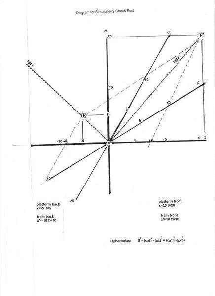

Simultaneity Check for Light Flash in Train and Platform Frames
  • Level: Graduate
  • Thread starter Point Conception
    Simultaneity
11 replies · 4K views · last reply
Point Conception
1,201
1,992
If the below algebra is correct then a light flash originating from the center of a train with .6c will be observed inside both train and platform reference frames as striking the back in less time.
Given : train length= 20ls
v = .6c
lorentz factor .8
As observed from the platform the front train clock=t0 and back train clock = vx/c sq
=t12
As observed from platform clock the light strikes the front of the train at 1/1-.6 (.8)(10)
=20s and strikes the back of the train at 1/1+.6(.8)(10) =5s
this is in accord with (t)front- (t)back= vL/lorentz = .6(20)/.8 =15s
As observed from inside the trains reference frame the light strikes the front at t-vx/LZ
20-.6(12)/.8 =16s
And strikes the back at 5-.6(3)/.8 = 4s
Also both train clocks as observed from platform read t16
So is the above correct. that is from inside both train and platform reference frames the
light strike event at back of train is first ?

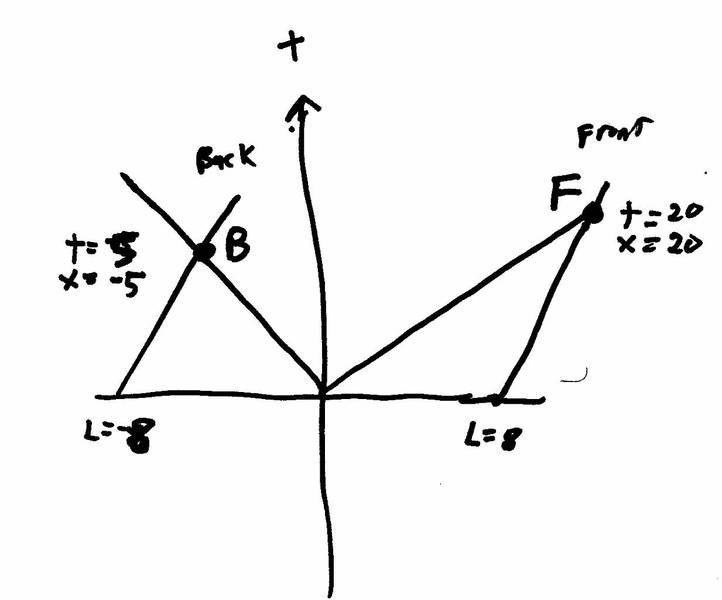

No, as I said above all your figures are correct except for the one about the time-coordinate of the light hitting the back in the train's frame. Again, time-coordinates in a given frame are simply defined in terms of local readings on synchronized clocks at rest in that frame, so if you agree that both clocks read 16 seconds when the light hits them you should agree both events happen simultaneously at a time-coordinate of t' = 16 seconds in the train rest frame. And if light from a single flash at the center took different amounts of time to reach the front and back in the train's rest frame, this would clearly violate the rule that each frame must measure the speed of light to be the same, so that's another way of seeing that your figure for the time-coordinate in the train's rest frame can't be right.
It's a bit hard to follow what you wrote without a diagram, does the following attached scanned space-time diagram match what you want?
In the lab frame, the front of the train starts out at x=8,t=0 while the back of the train starts out at x=-8, t=0.
The length of the train is thus 16 light seconds in the lab frame, which corresponds to a proper length of 20 light seconds.
Solving the equations for the light beam emitted at t=0 in the lab frame we find
point F: t=20, x=20
point B: t=5, x=-5
where point F is where the light beam intersects the front of the train, and point B is the point where the light beam intersects the back of the train.
I think this matches your lab-frame numbers now, so hopefully this is what you had in mind.
We can use the Lorentz transforms to convert these lab-frame coordinates into the train frame.
Let t' be the time in the train frame. Then using the standard Lorentz formula with c=1 (1 light second / second) we have:
[tex]t' = \gamma \left(t - vx \right)[/tex]
where v=.6 and [itex]\gamma = 1/.8 = 1.25[/itex]
This gives
point F: t' = 1.25 ( 20- .6*20) = 10
point B: t' = 1.25 (5 - .6* -5) = 10
thus t' is equal for point F and point B in the frame T', as we expect, and it's also equal to 1/2 the proper length of the train, as we would expect.
I didn't bother to compute x', but you can compute it if you like (it doesn't matter for the problem, though).
  • Hand-drawn space-time diagram with t axis vertical and x axis horizontal. Point B at t=5, x=-5 and point F at t=20, x=20 lie on a light ray from the origin. Lines marked L=8 and L=-8 are labelled Back and Front.
pervect, I think part of the problem is that morrobay wants to have the clock at the front read a time of 0 s and the clock at the back read a time of 12 s at the moment the flash is set off, as observed in the platform frame. This would mean the clock at the center of the train would read 6 s at the moment the flash is set off at coordinates x=0, t=0 in the platform frame...and this in turn means that if you use the Lorentz trasform, which assumes that x=0, t=0 in one coordinate system matches up with x'=0, t'=0 in the other, then the time coordinates of events happening at the front and back of the train in the train's coordinate system won't actually match up with the local readings of the clocks on the train when the events happen. In particular, while it's true that the Lorentz transform says that in the train's frame the events of the light hitting the front and back will both happen at time-coordinate t'=10 seconds, the clocks will actually read 16 seconds when the light strikes them. Alternately, you could have the train-observer use a coordinate system whose time-coordinates did match up with the clocks (which is what I suggested seemed simplest to me), but then you could no longer use the Lorentz transformation formulas, I suppose you'd need to use a Poincaré transformation instead.
The problem would be a lot simpler if we assumed that at the moment the flash was set off, the clock at the front would read -6 seconds and the clock at the back would read 6 seconds in the platform frame, so the clock at the middle would read 0 seconds at this moment (at coordinates x=0 and t=0 in the platform frame), and a coordinate system based on this system of clocks would relate to the platform-observer's coordinate system by the simple Lorentz transformation equations.

Yes the second link ( Galileo) you listed is correct and the relativity of simultaneity pages.
The first link (Panda). yes that is the paragraph I was referring to.
Well I am going to be looking at all this for awhile- thanks for the information.
I would like to see a good spacetime diagram of this situation and with the train frame
at t0 front t6 center and t12 back
diagram for" simultaneity check" post 12/04/07
Diagram for Simultaneity Check post of 12/04/07
  • Spacetime diagram with ct vertical and x horizontal, showing light rays from an event at the origin, two events E and E' on the light lines, worldlines of a platform and a train frame, and tick marks labelled 5, 10, 20.
