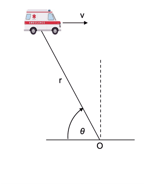

I do not see the need for a step function or an idealization. Here is the math that accompanies my comments in post #6.
The Doppler equation for a stationary observer relative to the medium is $$f_{\text{obs.}}=\frac{c}{c\mp v_s}f_0$$ where
##f_{\text{obs.}} =~## the observed frequency;
##f_0 =~## the emitted frequency;
##c=~## the speed of sound;
##v_{\text{s}} =~## the speed of the source relative to the observer; the upper/lower sign is used if the source moves towards/(away from) the observer. "Towards and "away" means along the straight line joining the source and the observer.
Diagram of an ambulance moving right with velocity v, its position joined by line r to point O on a horizontal ground line, with angle theta measured from the vertical dashed line.
We can safely assume that the observer O has heard the siren and is standing on the sidewalk watching the ambulance go by (see diagram on the right). The radial component of the velocity towards/(away from) the observer is ##v_{\text{radial}}=v_{\text{s}}\cos\theta.## The Doppler equation becomes $$f_{\text{obs.}}=\frac{c}{c- v_s\cos\theta}f_0.$$ Note how the cosine in the denominator automatically takes care of all that needs to be taken care of.
In those variables you cannot see how the step function of timr becomes the limit as the distance of closest approach goes to zero. This is because it is obscured by the fact that in the corresponding limit, ##\theta## approaches a step function in time.
Again, I am not saying there is a need for making that approximation. I am saying that making such an approximation based on the wording in the problem would not be very different from making other implicitly assumed approximations in other problems at the same level. And if you do, then you may mess up the answer relative to the intended one.

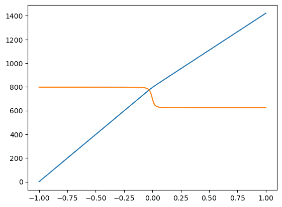

Here is a plot:
Line plot with two curves against an unlabelled horizontal axis from -1 to 1. A blue line rises steadily from 0 to about 1420. An orange line stays near 800 on the left, drops sharply near 0, and levels off near 625.
The input data are:
##v = 150## km/h
##d = 1## m
##c = 340## m/s
##f_0 = 700## Hz
The x-axis has units of seconds.
The orange line is the observed frequency in Hz.
The blue line is the number of wavelengths passing by the observer since ##t = -1## s.
We can observe that, yes, the orange line is continuous, it is equal to ##f_0## at ##t = 0##, and it decreases. This is the purely mathematical answer, but physics is an empirical science. We need to ask ourselves if this is detectable. The frequency goes to a constant essentially 0.1 s after the passage. If we assume the "detector" to be a human ear, this is most likely way too short to distinguish from an instant change in the frequency.

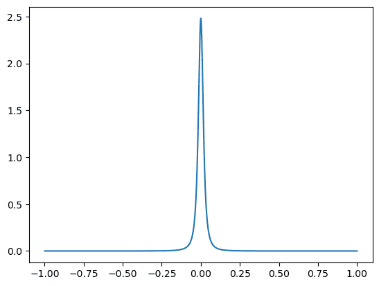

Even if we do not assume a human ear, but a more ideal detector, there is this graph:
Line graph of a single sharp peak centred at zero on the horizontal axis, rising to about 2.5 on the vertical axis and falling back to near zero on both sides, with the horizontal axis running from -1.00 to 1.00.
The x-axis is still time in seconds and the graph shows the relative change in frequency during one full oscillation. To meaningfully talk about the frequency of a wave, the frequency should not change appreciably over one period - or ideally several periods, meaning that this graph should be well below 1, which again, it is not for times around the passage time ##t = 0##.
Could you detect the very small changes in frequency after ##t = 0.1## s? If you have an extremely sensitive detector, perhaps, but for most practical measurements the frequency - where meaningfully defined - is going to be effectively constant.
Edit: Put somewhat differently: Within all of the idealisations made, you have not taken into account the idealisation of the observer that should detect the frequency change, but simply assumed that this observer can measure frequency with infinite precision over an infinitesimal period of time.
