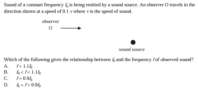

Please see below
##f_2=\frac{v\pm v_o}{v\pm v_s}f_1##
My answer is (A) but the correct answer is (B).
My attempt:
$$f_2=\frac{v\pm v_o}{v\pm v_s}f_1$$
$$=\frac{v+0.1v}{v}f_o$$
$$=1.1f_o$$
If we consider the observer to move pass through the sound source and now is moving away from the stationary source, then:
$$f_2=\frac{v-0.1v}{v}f_o$$
$$=0.9f_o$$
My questions:
1) why the answer is not ##0.9f_o\leq f\leq1.1f_o##?
2) based on the doppler effect formula, the frequency heard by observer will be constant (higher) when the observer is approaching the source (or source approaching the observer) and will also be constant (lower) when observer is moving away from source (or source is moving away from observer). But in real life, when ambulance is approaching me, the sound heard will be louder and louder (not constant) as it is approaching. This seems to contradict the formula. Or maybe the sound is louder and louder due to amplitude is increasing but the frequency stays constant?
Thanks
It is not made clear, but it seems you are to consider the instaneous position shown, not the whole transit.
Only if on a line through the source.
Amplitude is independent of frequency, but loudness is a matter of perception. The human auditory system is more sensitive to some frequencies than others.
The image shows the obsever travelling towards, but not straight at, the source. I would assume the question intends to ask about this particular setup.
This means that the observer approaches the source with a speed lower than ##0.1v##. Since it us an approach, the frequency cannog be lowered.
I understand.
