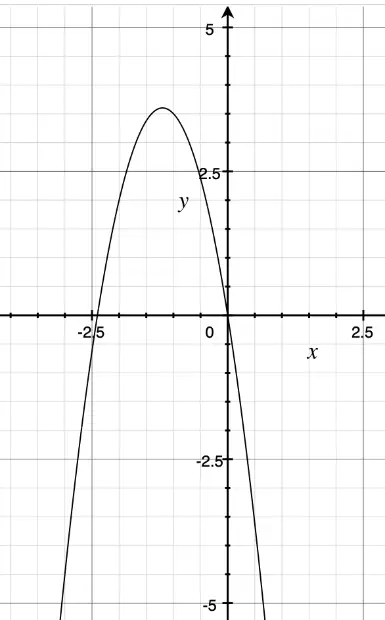

Since the force is conservative, this problem can also be solved by using mechanical energy conservation. Taking the zero of potential energy at the origin, the potential energy function is $$U(x)=-\frac{5}{2}x^2-6x.$$ If it is at rest at the origin, it will move in the direction of decreasing potential energy, i.e. +x and keep moving in that direction.
A plot of ##U(x)## is shown on the right. There is a maximum at ##x=-1.2~\text{m}## where the force is zero. It the object is on the negative axis moving towards the origin, it can (a) go over the hump; (b) stay at the hump in unstable equilibrium; (c) never reach the hump and go back where it came from. None of these possibilities allows for the object to be at the origin and have zero velocity.
Therefore, if the object is moving at ##t<0##, it must have negative velocity such that it reaches the origin with zero speed.
We see, then, that at ##x=4~\text{m}##, the
  • obvious interpretation (the object is at rest at the origin until the force is turned on) leads to the velocity ##v=+8\sqrt{2}~\text{m/s}.##
  • less obvious interpretation (the object is already moving to the left so that it reaches the origin with zero speed) leads to the velocity ##v=-8\sqrt{2}~\text{m/s}.##
If I were asking this, I would make it a multiple answer question in which (a) and (b) would be correct and make it clear that we know that the object has zero velocity at O but we don't know whether it is an instantaneous value or not.
