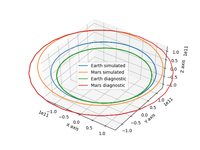

Hi, as a side project I am making a solar system simulator in Python, but I am getting extreme inaccuracies.
As the image shows - I am comparing the simulation to data obtained from NASA's Horizon.

The image is with a timestep of dt = 86400 seconds (24 hrs) but I have tested down to dt = 86400/256 and there was no visible improvement.
Diagnostic is from actual positions at different times? It looks like Mars is too slow and Earth is too fast. That rules out a wrong GM as source.

I noted that the diameter of the orbit is smaller in both cases. Was wondering if you had correct value for G or wrong calculation for the gravitational force or something like that? I'm not a programmer (Python or otherwise) but are you using gm for the gravitational force or GMm/r2 or ??
Sorry if that's way off beam.
Edit: Actually I'm wrong. The simulated orbit for Earth is bigger but the simulated orbit for Mars is smaller.
I am using GM, I rechecked the values and they seem correct. Thanks for the suggestion :)
I have written a a basic Verlet integrator in the Python class posten below:

And then calling the Body.step() method for each planet individially - but I am unsure whether this is the correct approach. Any advice would be welcome.
