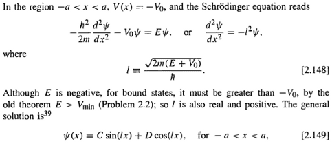

That is eulers formula i know and i can ALMOST derive the connection between the example used in books: ##\scriptsize \psi_I = Ce^{i\mathcal L x} + De^{-i \mathcal L x}## and the first general solution to the DE: ##\scriptsize \psi_I = C\cos (\mathcal L x) + D \sin (\mathcal L x)##.
Here it goes:
\scriptsize
\begin{split}
\underbrace{Ae^{i\mathcal L x} + B e^{-i \mathcal L x}}_{{\scriptsize \text{used in the books}}} = A \cos(\mathcal L x) +A i \sin (\mathcal L x) + B \cos(\mathcal L x) - B i \sin(\mathcal L x) = \underbrace{(A+B)}_{\equiv C} \cos(\mathcal L x) + \underbrace{(A-B)}_{\equiv D} i \sin (\mathcal L x) \neq \underbrace{C\cos (\mathcal L x) + D \sin (\mathcal L x)}_{{\scriptsize \text{solution to the DE}}}
\end{split}
I can notice that the function used in books is NOT equal to the solution to the DE. It is diffrent for an imaginary number ##i##... Here is allso one small snippet from Griffith where he doesn't use ##i##. Take a closer look to the eq. 2.149. I am sorry for posting a snippet, i can remove it if necessary. So my question is why or how does ##i## dissapear?
You are right except that D=(A-B)i, the i is included there and the two forms of the solution are equivalent.
The constants don't have to be real.
